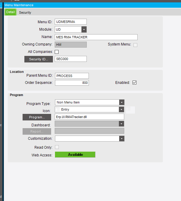

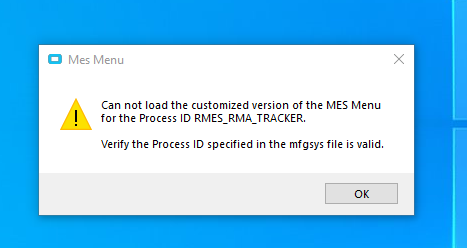

Followed and then i changed the menu ID in the sys config to try and pull the customized version and i got prompted with this. image
Post a screenshot of the item in Menu Maintenance.
When i tried using the UDMESRMA in the config file it didnt open anything or say anything on the customization.

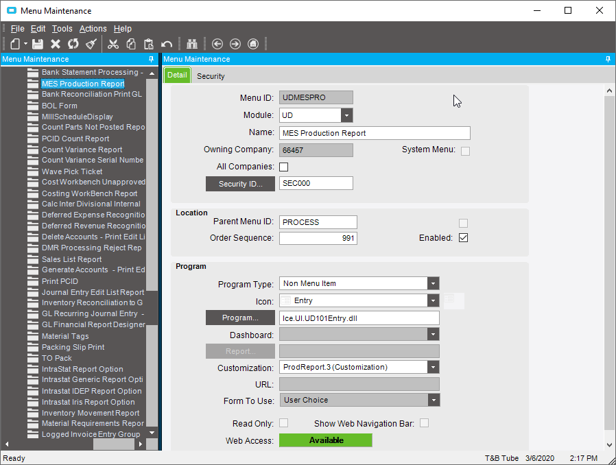

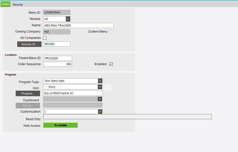

At the bottom where it says customization you need to select the MES customization with the button that you created in MES. That will tell it to load that version of the MES customization with UDMESRMA in the sysconfig file.
I kind of don’t have that option.
