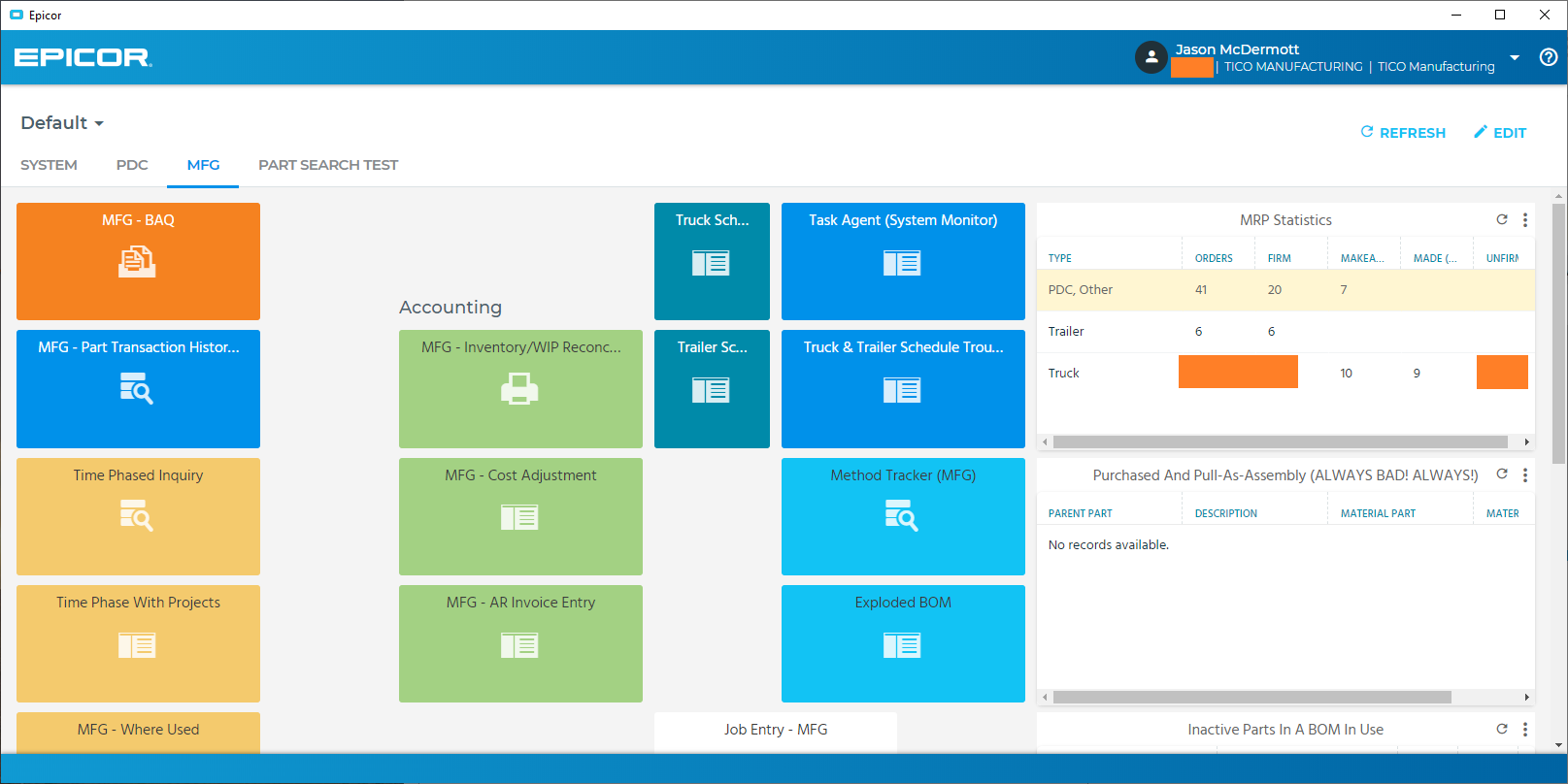

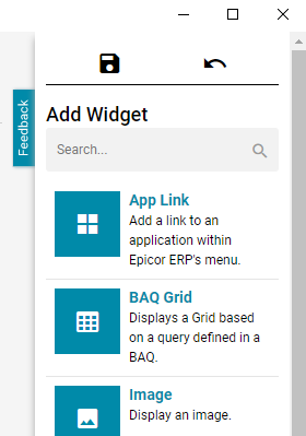

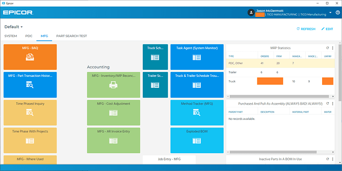

Here is my home screen. You’ll notice there are BAQ grids and links to the BAQ designer and accounting screens. (Orange boxes are me blocking sensitive info.)

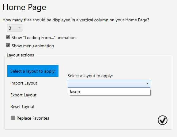

And actually all I did was import my normal home-screen layout, but you can create from scratch, too.

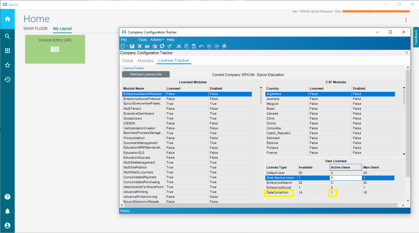

And I checked - a lot - this still uses a data collection license.

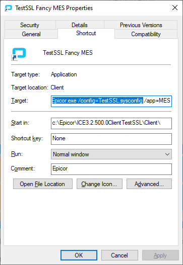

How to get to this screen

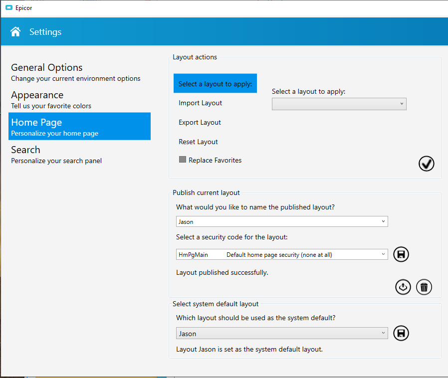

It’s just a special shortcut. Copy any shortcut to Epicor. In properties, the end of the target is
/app=MES
Old vs. new
  • No need for the config change on every client and adding a menu item to Epicor. It’s just a layout. Publish it from the settings page when you (a security manager) are logged in to MES

  • The only way to edit the layout is if you are a security manager. Yep, that was a heartbreaker. So I have to publish layouts for others to use and they can never edit them.
  • An ordinary user cannot change her layout from the drop-down,on the main screen, as far as I can tell, but she can change it in settings.

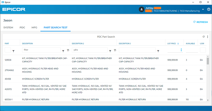

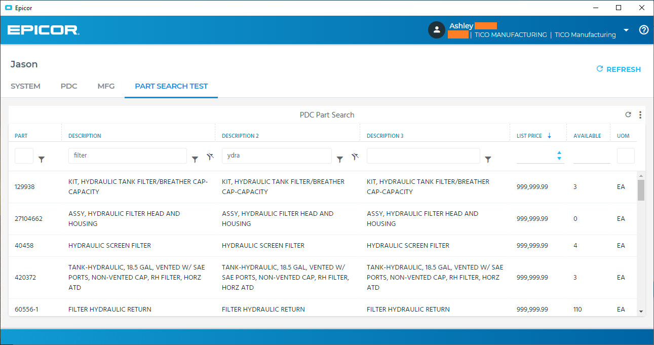

Sure, you can make dashboards for MES users, but the Kinetic option opens up the ability to do something like this. I made this for sales. It’s a BAQ grid of all the parts in that site, with filters.Yes, I know, a dashboard can have filters. But this is WAY better because:
  1. It’s MUCH faster. It responds instantly.
  2. The filter boxes are right there. Just click and start typing.
  3. You can do partial description searches, even the middle of a word. I did “ydra” for “hydraulic” in the pic.
  4. It’s right on the home screen. No waiting for a screen to load.

I found in testing that in 10.2.600, they brought in the search and menu tree, and any user can customize their layout. It looks just like the full version.
Still the restriction on Open With, though.
This is demo DB, obviously:

@JasonMcD, that dashboard looks nice and I would like to do something similar for our parts group. I like that it responds quickly and the search is not required to be “Starts with”.

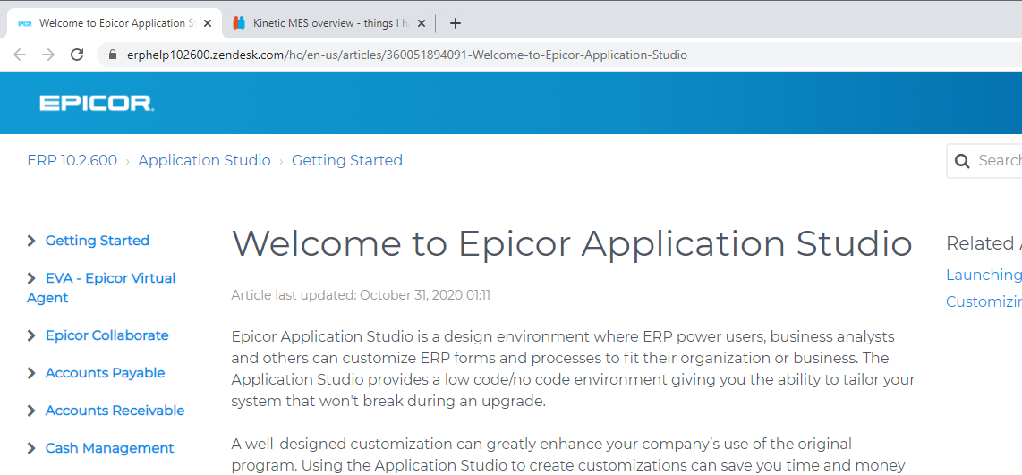

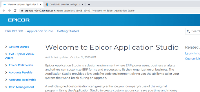

Is there an Application Studio User Guide somewhere? I have searched, including in Embedded Education, but I have not been able to find one.
@BKen I had bookmarked this, but it looks like it does not work anymore:
https://erphelp102600.zendesk.com/hc/en-us/articles/360043282331-Welcome-to-Epicor-Application-Studio#
It just returns “Please access Epicor documentation from the Help menu in your Epicor application.”
FYI, the description columns are two or three calculated fields referencing the same description. Kind of hacky, but it sure works.

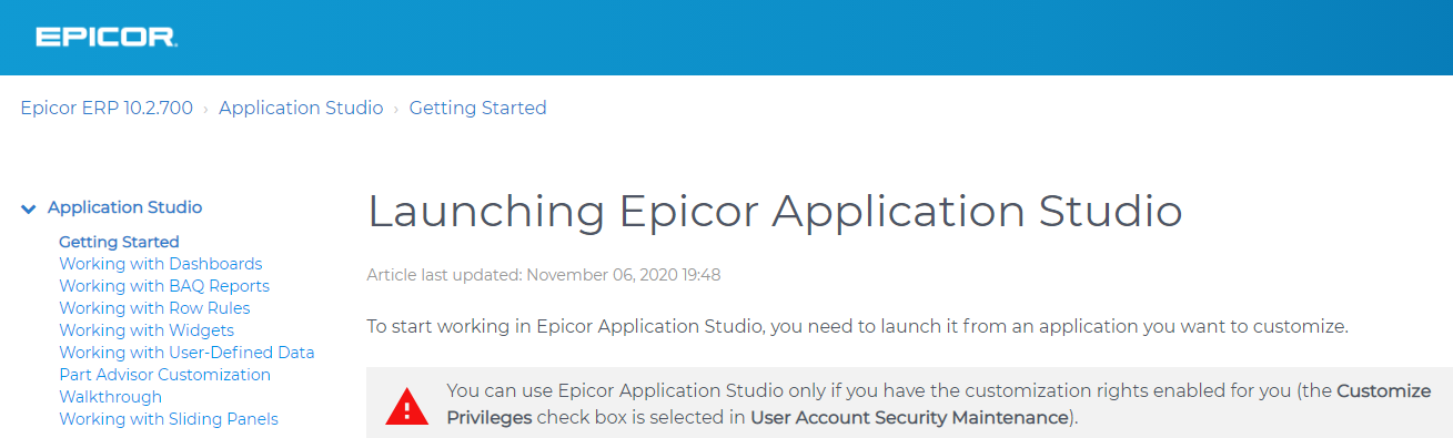

I’ve only seen what’s in the 10.2.700 help, which you can access from EpicWeb.
I’d also keep an eye on this site in EpicWeb:
https://epicweb.epicor.com/products/epicor-erp-10/kinetic-resources
@BKen, @Mark_Wonsil
Click the Question mark in the corner
It takes you here:
Learned that on the Midwest EUG webinar last week.
@Mark_Wonsil, thank you. I do have that site bookmarked already.
@JasonMcD, thank you. I clicked the question mark (and because we are public cloud) it brought me to the 10.2.700 Zendesk site (so I have some additional reading to do). On the description columns, did you have to manually create the two or three references of the same description? Was this needed to find the mid-word text string in the search results? Can you share your dashboard?
It’s just a BAQ. No dashboard, just the normal “grid” app.
The BAQ is embarrassingly simple:
@JasonMcD, you are right…embarrassing for me. Thank you for your help.
