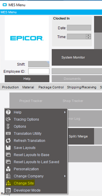

I have several employees that are trying to log into one of our plants and are getting the error message:
Job XXX is located in Site XX. Access not allowed.
I know it is something simple but I cannot figure it out. They all have aces to the site
When a user opens MES, they are already logged into a specific site. If the job you need is in a different site, you will have to change sites. If you don’t have “Change Site” in your right-click, the only way I know to change a site is to have that same user log into standard Epicor, change the site, and then close. Then when they log into MES, they will be in the new site.
Thank you. Sorry it took so long to get back
