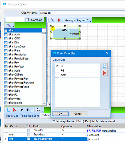

There is the one option in the condition widget where you design a query and then your condition is usually based on if the query returns any rows. Within the query designer, you can see if ttPart.ClassID is in a constant list. You can then specify (in double quotes) all the classes you want it to include.

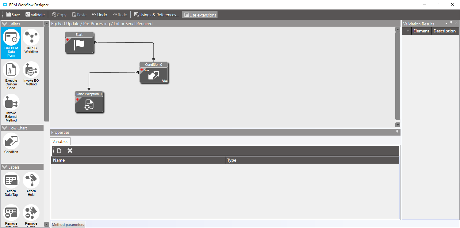

pick this condition everything else is in the picture. That constant list is the IN you want and the rest is BAQish. If it throws an error on saving wrap the part classes in quotes.

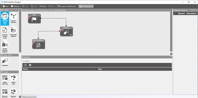

Tried the suggested and get this when trying to save the BPM. The query creation went fine, and the workflow validated fine. It will save as long as it’s not enabled. I will be back at this tomorrow.
There is at least one compilation error.
Update.Pre.Lot_or_Serial_Re.cs(66,48): error CS0103: The name ‘False’ does not exist in the current context
Update.Pre.Lot_or_Serial_Re.cs(67,53): error CS0103: The name ‘False’ does not exist in the current context
Update.Pre.Lot_or_Serial_Re.cs(68,32): error CS0103: The name ‘SP’ does not exist in the current context
Update.Pre.Lot_or_Serial_Re.cs(68,36): error CS0103: The name ‘FG’ does not exist in the current context
Update.Pre.Lot_or_Serial_Re.cs(68,40): error CS0103: The name ‘FGF’ does not exist in the current context
in BPMs you have to use double-quotes " in the BAQ designer. It’s weird but that’s probably what’s going on.
Can you upload a screen shot of the condition and possibly the bpm?
I’m walking out the door but I’ll post this up to bake till tomorrow. The only problem I see with this is shouldn’t the part they are working on or saving be a driving filter on the query? That way if that part fits those conditions then it’s present on the query making the statement of “is more or equal to 1” accurate? Because right now if I just run the designed query with that criteria then it’s always going to have a row since some currently exist this way.

In my version I had to use double quotes on the list and a constant of lowercase false. I threw in our 0000 class to test it.

That did the trick!
