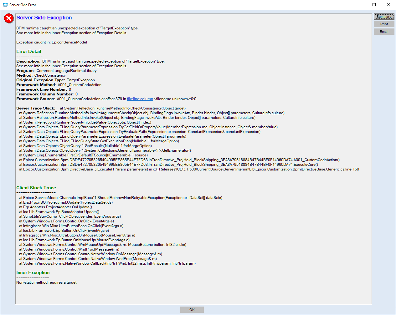

Good morning Mega-Minds! I’m trying to automatically create a new record in the ShipHead and Detail tables when a user clicks a button on a dashboard. Once the button is clicked, a UD field in the Project table is updated, which triggers this new BPM in the Project/Update BO. The problem is that I’m getting a TargetException error right at the start of the BPM, when trying to create a new record in ShipHead. I have NULL capture code, and am not sure why I’m getting this error. Below is my code, along with the error.

Is your new method called “BlockShipping”?
If not, it looks like that could be interferring.
It isn’t. That might very well be it.
Your error is referencing an InTran Directive called ProjHold_BlockShipping.
Check that out as that’s what’s causing your error, not your new one.

I disabled my BlockShipping Data Directive and everything worked fine! I didn’t even think about another directive causing the issue. Thank you for your help! :grinning:
