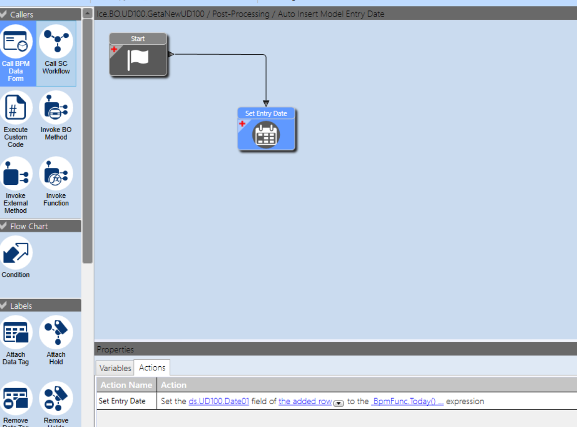

I have a Post-Processing BPM on SalesOrder.GetNewOrderRel that is quite simple:
It checks to see if ttOrderRel.RowMod = “A” and if it does, it sets ttOrderRel.EntryDate_c to today’s date.

I don’t think you need the condition check the GetNewOrderRel.
Action, set the added row. instead of changed row

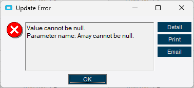

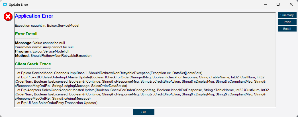

I am trying to apply this same sort of BPM to the OrderDtl table, but it is throwing an error:

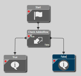

So I started from scratch on OrderDtl. The In-Transaction Data Directive on OrderDtl is this:
The conditional is:
The True/False Message Boxes are just that…they say either True or False.
How is the Conditional throwing a “Value cannot be null.” error?
