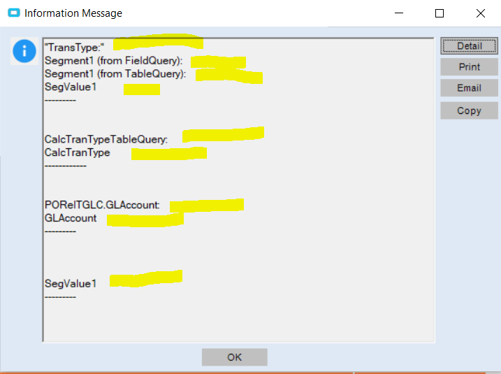

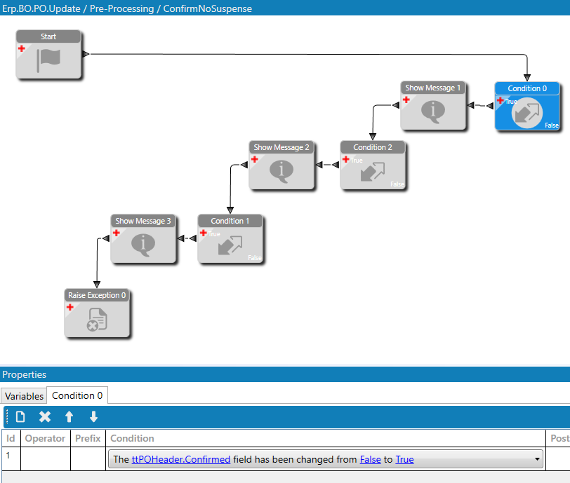

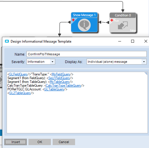

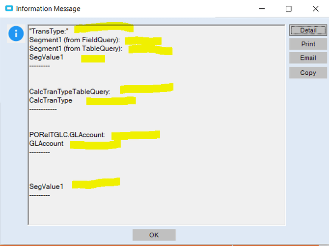

So I have tried a pre-processing Method Directive, but the ttPORel.TranType is null, the ttPORelTGLC.SegValue1 is null, so I cannot determine if my conditions have been met. I am able to see that ttPOHeader.Confirmed went from False to True and I put a message after that (to tell me what the previous two fields are; TranType and SegValue1).
Here is the message fields:
Here is the message when it pops (all are null, that is why I jumped to a post processing method directive):

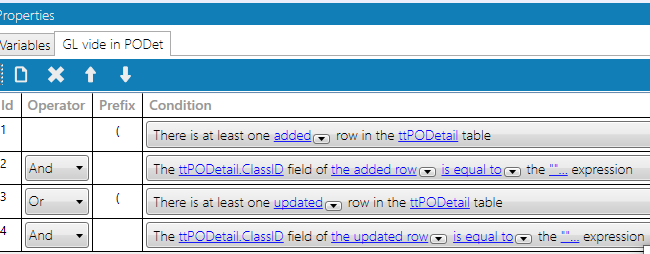

You are indicating ALL ROWS. I am reading this as if all rows must = PUR-UKN.
I never used this. but it my understantding… ?
For exemple for myself I wanted to prevent saving if the detail classid was missing.
Then used the exception message to prevent saving…

I agree that I do not like how the phrase is written, but based on the choices available, I suspect this is a setting to determine which rows are being evaluated (the added row, the deleted row, the updated row, the changed row, all changed rows, or all rows).
So I suspect, it is not stating that all rows must equal “PUR-UKN”, but evaluate all rows to see if at least 1 equals “PUR-UKN”. In my post-processing Method Directive have confirmed that even though not all rows are “PUR-UKN”, that my condition for all rows does become true.

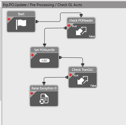

The following should work:
edit
The below has a bug. See about 4 posts down for the fix
end edits

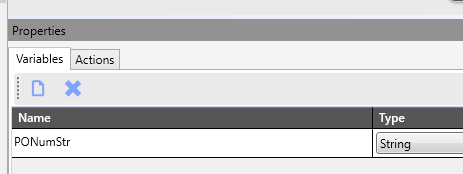

Set PONumStr widget expression:
ttPOHeaderRow.PONum.ToString()

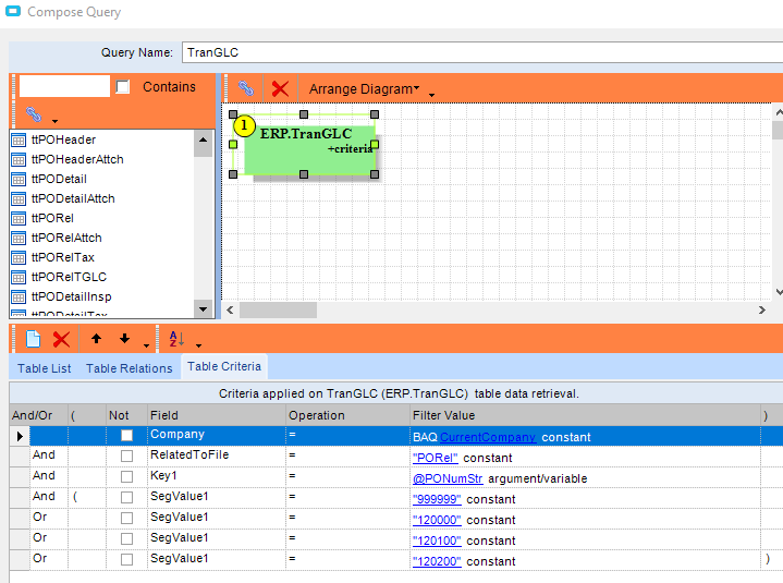

Condition0:
Query in Condition0

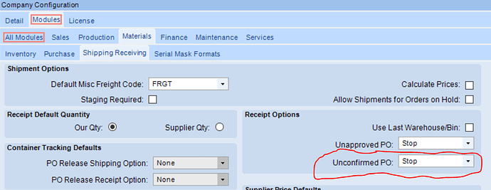

We want this set on the Confirmed box because many of our POs are time sensitive. We do not want to slow down the issuing of a PO, but we do not want to receive the goods in with a wrong GL (and we have this set on our company config).
For this reason, we want to check the GL when the confirmed checkbox goes to true. You are right, that there are probably no changes or updates to the lines or releases at this stage, which is why I was evaluating All Rows. My post-processing Method Directive conditions do become true.

I am pretty sure that “All Rows” means that all rows must match the condition.
I found a bug (or two…) in my solution… it would bomb on updates to that didn’t touch the ttPOHeader table. Because with no data in the ttPOHeader table, the “Set PONumStr” widget’s expression would raise an error (can’t use the .ToString() method on a null)
Put the two conditions into two separate condition widgets:
The first checks for the change of ttPOHeader.Confirmed You have to do this first, to see if the tt POheader table even exits. If it doesn’t then you couldn’t set the PONumStr variable.
Calvin,

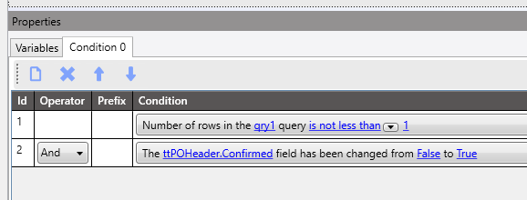

I have not used a condition of the query before, but it is really nice. Here is what mine looks like:
So is there a widget or way to refresh after the raise exception (to show the checkbox’s true state)? Or should I set the Confirmed field to false, show a message, and then is there a widget to save at that point?
The “Raise an Exception” widget prevents the BPM from completing. So the Confirmed flag is actually still not set. In that Exception widget you can display a message to the user that the Confirmed flag was not set, and that they need to refresh their screen.
Luckily, since the Confirmed field can only be changed on an Approved PO, no other fields could have been changed, and not saved.
