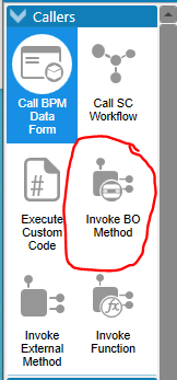

Have you ever discovered a way to refresh the display as you were trying to in this post? I have been looking for this specific solution for a number of BPMs and this specific function would be so helpful, because, as you mention, users don’t bother to read any message that isn’t an error.
Thanks for any help or insight you may have.
I think many people may be using the widget “Invoke BO Method” and call GetByID to refresh the display.
Give it a try and let me know if this works.
