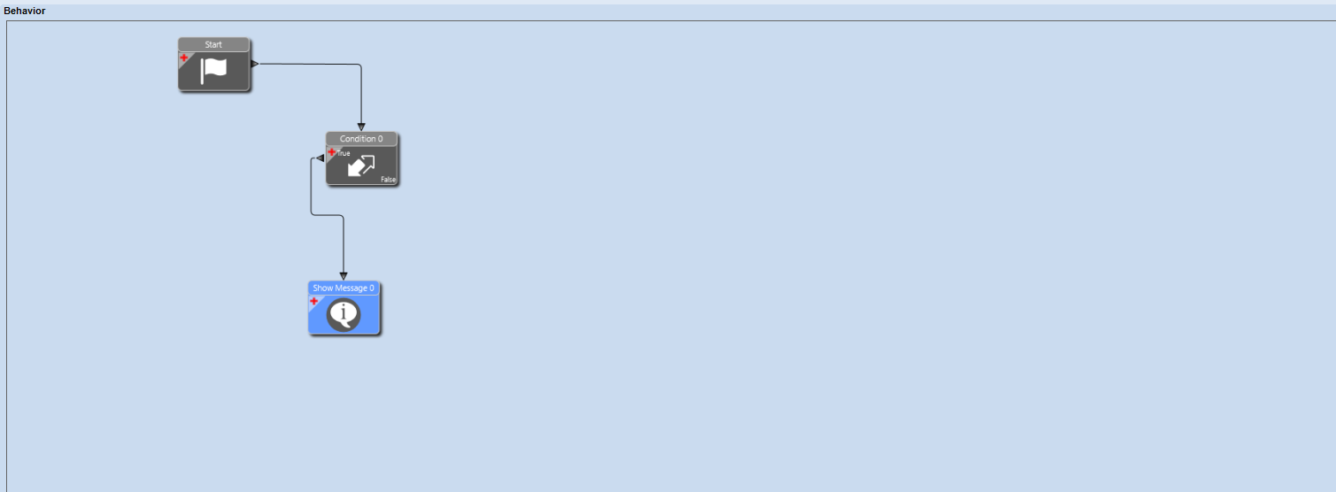

Can you tell us what you’re trying to accomplish and screenshot the BPM?
Initially I was just attempting to find the method. But now I can’t even get a simple trigger to fire. This literally just states, "if method is called by jseidl (me), show this message.
Using pre-processing on the ChangePartNumMaster Method.

Start taking screen shots of every screen that you use to make the BPM and posting. Something isn’t right, but we can’t see what you’re doing. If you show that, maybe we can pick out what you’re doing wrong.
Some kind of configuration as it seems. I’ve got other BPMs that do not work in the test environment that work in the production environment. All enabled, all the exact same.
