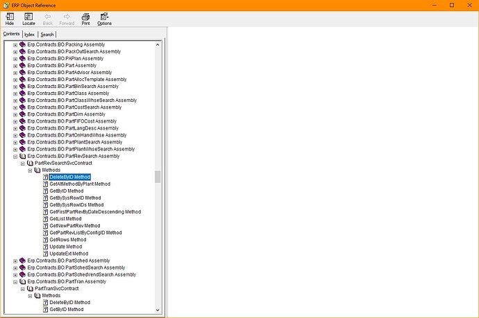

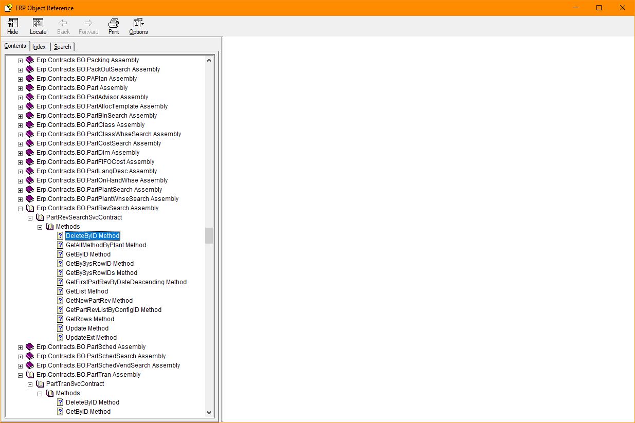

I opened this up and it looks like a help file browser. I see all the BOs and methods, but when I click on one, there is nothing showing:
Right Click on the file and Click Unblock (before opening it)
That was it! Thanks!

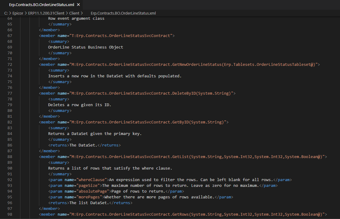

In your client folder, you will find xml files associated with each BO. You’ll have to parse it but I imagine it’s the same text in the documentation. For example:
Neither documentation will tell you which service is called in which order however. Only a trace will reveal that information.

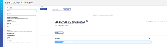

And OpenAPI/Swagger page too:
