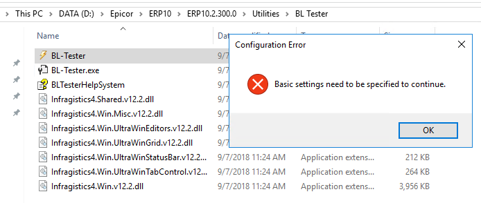

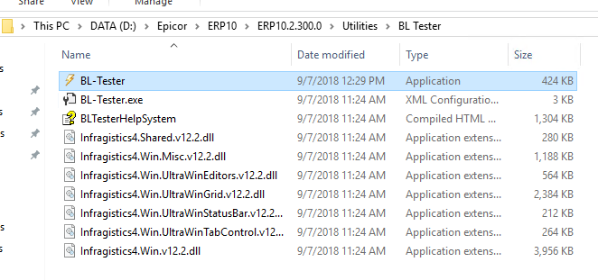

First, this tool is on the server, that’s where it lives and where you run it from when you need to use it. Correction, you can use this from your computer, you just set the connection string to the server that you are connecting to. Just copy all of the files in the BL tester folder to your local computer It’s located in the utilities section on the drive you have set up with epicor. This is ours. You run it by clicking on the lightning bolt application.

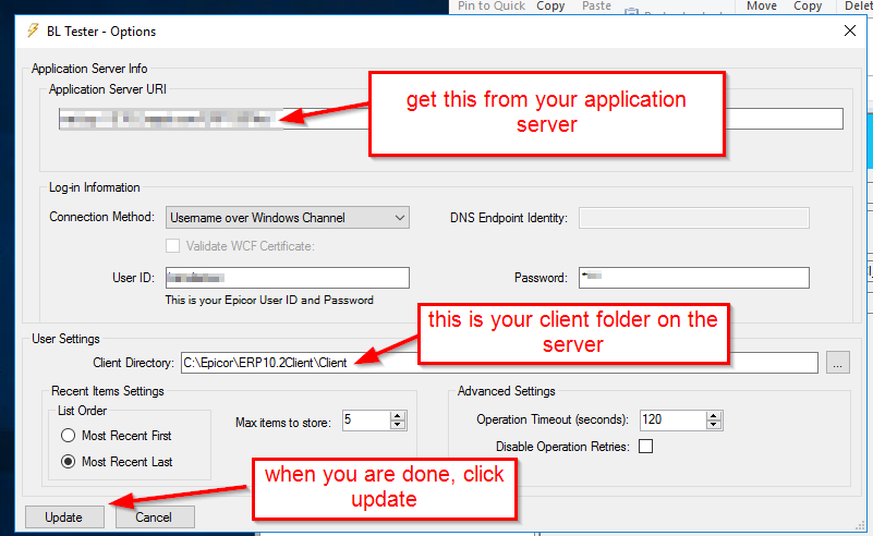

The first time you run this, this window pops up. And will bring you to a setup screen.
That will bring up this screen. You will need to set your Application Server URI, set you log-in info (Mine works as shown, I used my user and password, you’re login in requirements may be different)

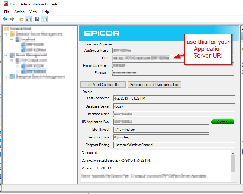

To find the URl you look in the administration console for the specific database you want to test it. I would highly recommend to NOT use your production database for this. Testing calls through this tool WILL affect the database if you make a call that is intended to change something.
Then you click update and you are in.

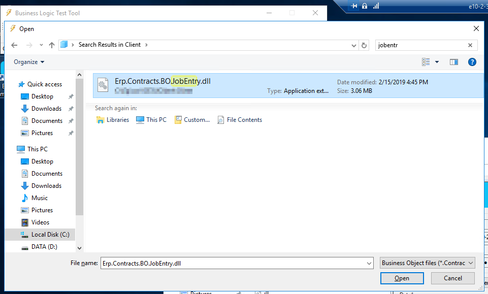

To use the tool, click file open
Then look for the BO that you want to check out.

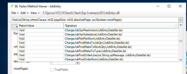

Now you have a list of the methods that reside in the business object so you can see what you can call.

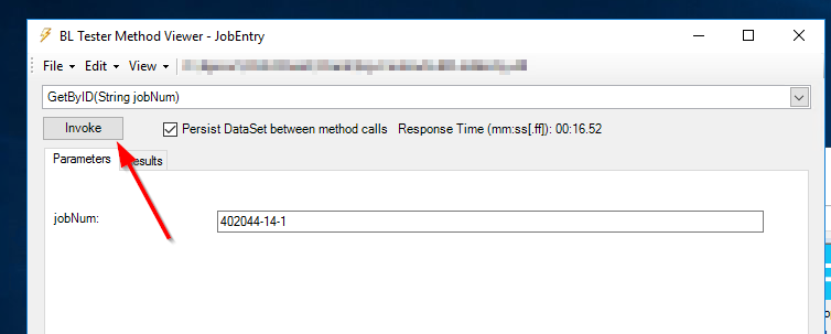

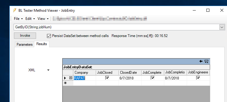

And you can see the parameters that are required, and even test some of the more simple calls.

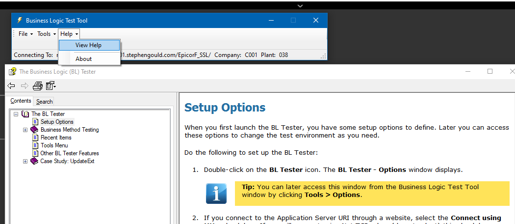

The help file also contains the setup / configuration plus a case study example of using it.

There is a limited help file in the BL tester, so if you open up that, you might be able to figure it out.
