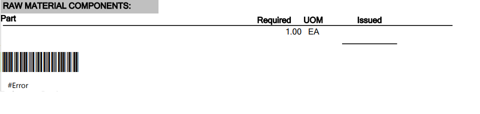

However, if “MyStatement:” isn’t detected then the textbox errors:
Am I missing a handler somewhere? Not exactly sure why its erroring.
If I’m understanding the question, it is because SSRS processes both true and false conditions regardless of the actual condition… I’ve personally been victim of this so you have to rewrite your iif statement in such a way that both true and false statements will be “valid”.
This link explains a little bit more about the phenomenon and even mentions InStr as a common culprit. This may not be the answer but I think it will direct you to a way around it.
IT Help and Advice: SSRS: Common Issues with #Error and IIF
After reading this I realized I could just use IF instead of IIF and then the statement worked as it should!
