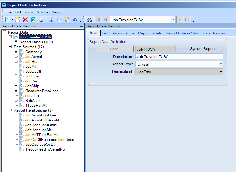

We kept our reports in Crystal. We went from 9.05.702 to 10.1.600.5.
Once we got UD fields dealt with, we found it wasn’t too hard to get most of the crystal reports working again in E10. Here’s our modified, upgraded job traveler for Crystal. I don’t think we have any UDs on this one.
