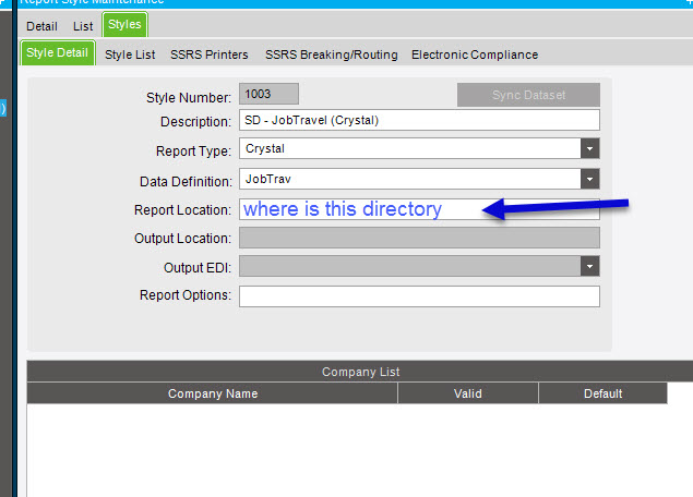

What does the location in report style need to look like:
I’ve tried the following and it just hangs when I try to print preview:
EpicorData/CustomReports/CustomForms/traveler.rpt
Which way is the slash supposed to go forward or backward for Crystal reports? Is there someplace in the application I define where the root of the EpicorData is or is that hardcoded in the Application itself?

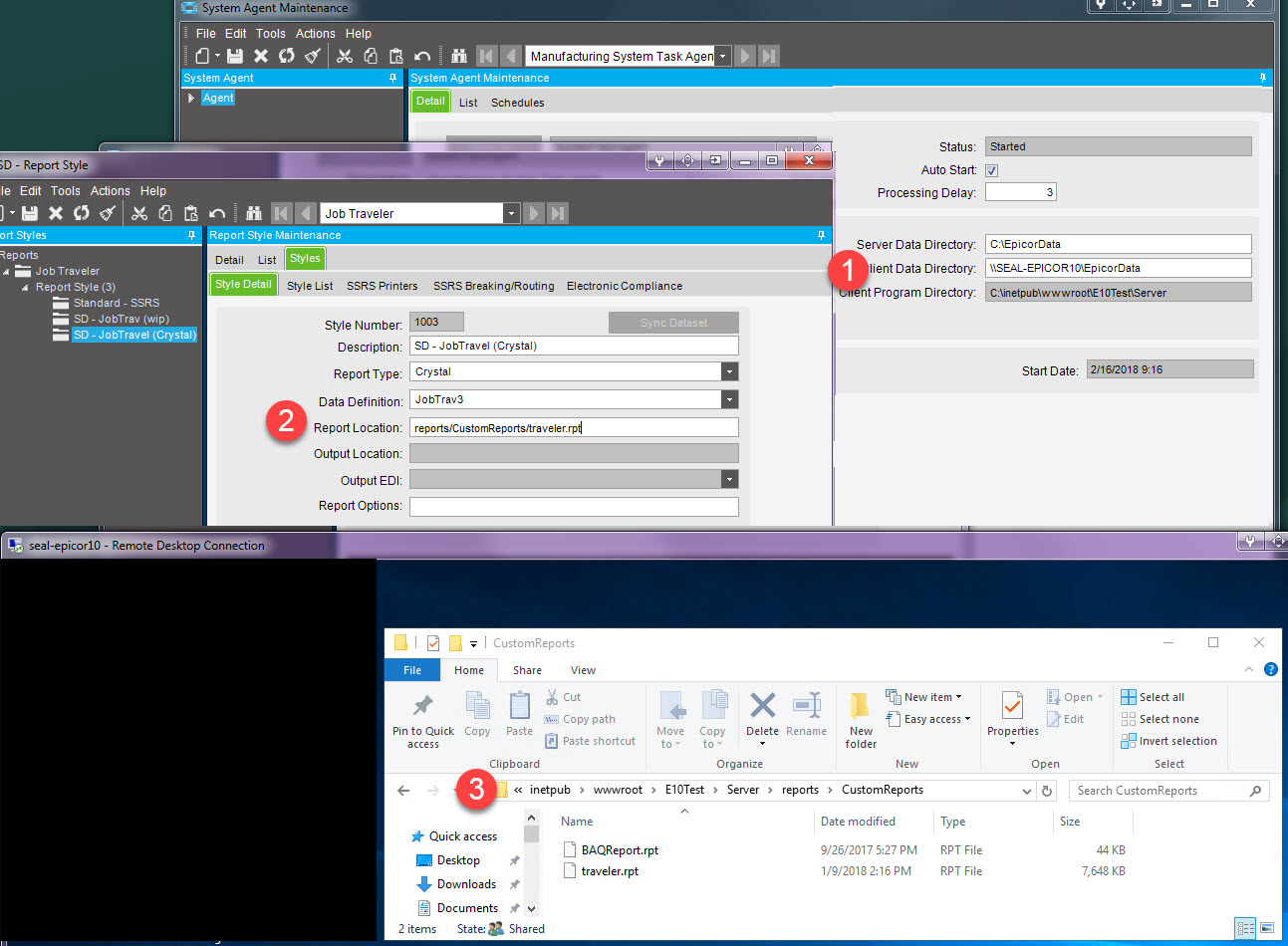

For anyone that’s looking where the setup is:
  1. System Agent Maintenance gives the base path (Client Program Directory)
  2. Report style will finish the path ( Report Location)
  3. On the app server you combine them into a long path and put the .rpt at that location. Using forward slashes /in/the/path/name
The way it comes over from E9 and earlier is reports/customreports/etc…
This can stay in place and seems to understand the reports as the EpicorData folder.

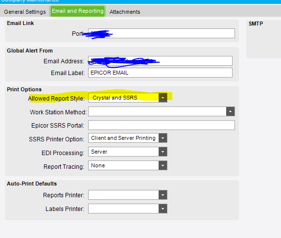

You will need to enable Crystal Reports in your Company Maintenance. In the Dedicated Tenancy product, the screen looks like this:

Finally got the correct directory so that the application can find the .rpt files.
I had to create a CustomReports directory inside the reports folder, which was confusing because the Reports folder normally just contains report data from users when they run a report.
