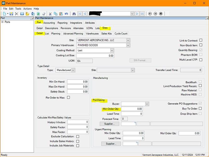

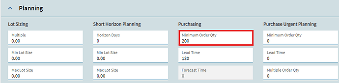

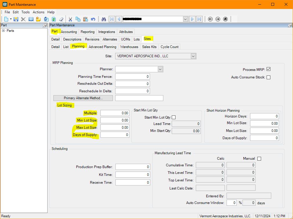

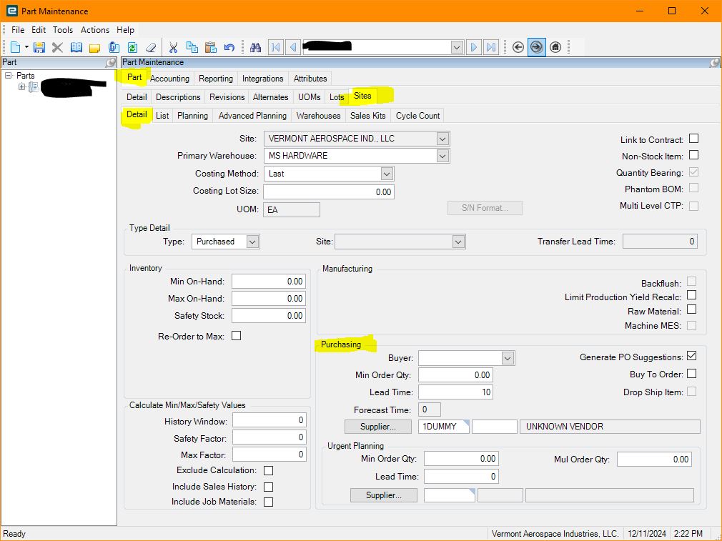

You can either edit the individual part’s lot sizing, or you can edit it by the product group. I always like the part settings, as we don’t use product group much. Open Part Entry > Part > Sites > Details. Some of the quantity sizing is listed here, and you can find more lot sizing options under the Planning tab.

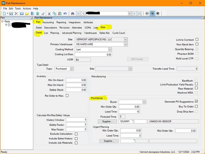

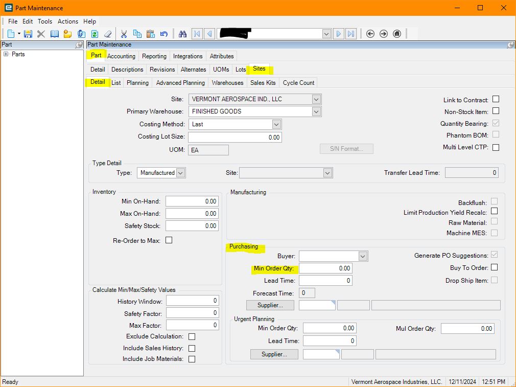

Thanks Nate. This lot sizing which highlighted is purchasing or manufacturing lot sizing
If the part is setup as a purchased part, then these are purchasing sizes. If the part is setup as manufacture, then these are manufacturing sizes. Additional purchasing specifics can be found in Part > Sites > Detail > Purchasing.
@NateS Tim has mentioned the MRP and Generate PO suggestions both these values.
@timshuwy , May I request you please show in the screenshot where to define and test this? Thanks much appreciated.
