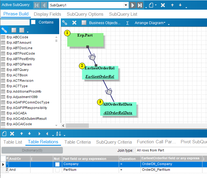

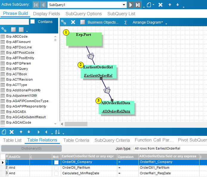

Far as I know, the only way would be to add the OrderDtl table to the query again and join to it. Well, and OrderRel and whatever else and do another subquery. Here:
Join from Part to SQ1:
Join from SQ1 to SQ2:

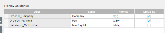

SQ1 and grouping:

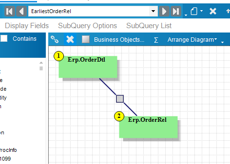

SQ2:

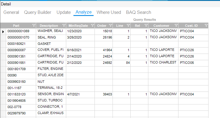

Results:
