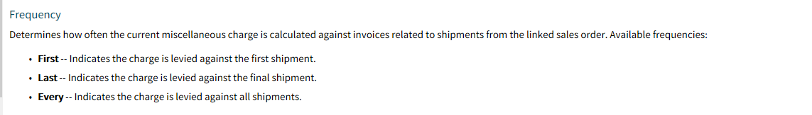

"Working as design
Based on the current logic results achieved are expected per steps provided, this functionality has not been changed since 10.2.700.40, therefore, the charge will be added to every line at invoice, however they can be manually deleted.
Since this could/would change the way the misc. charges works/generates for the Invoice, and might change the way a lot of customers works, this would require an enhancement request through an Idea in AHA. "

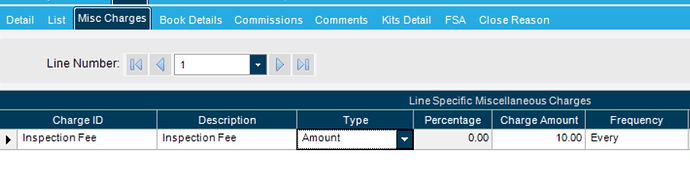

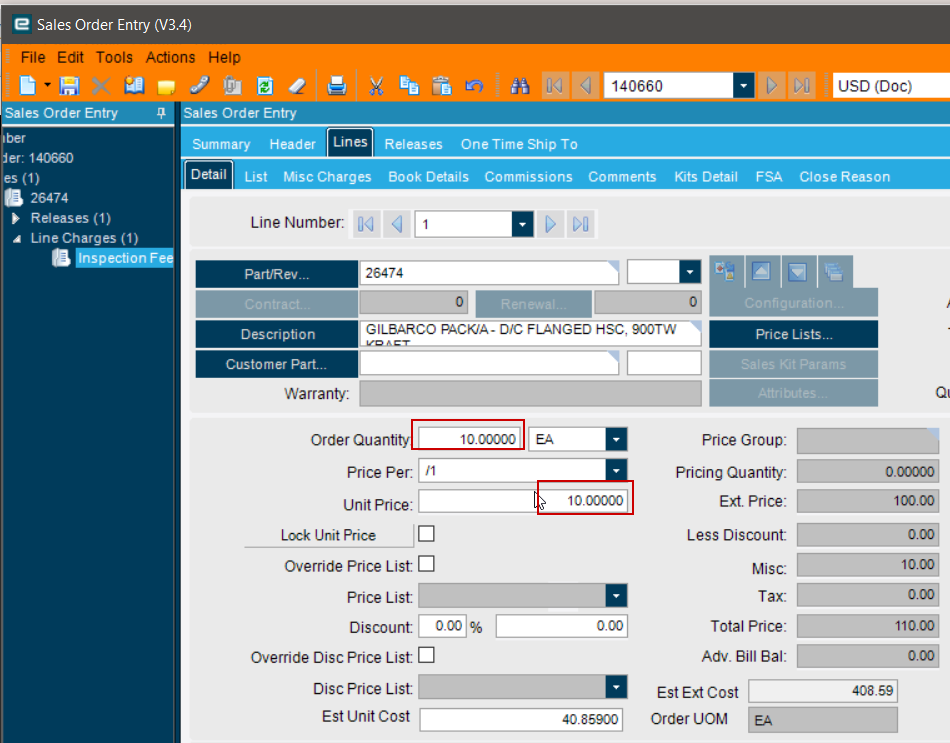

Order Setup:
Order Qty: 10
Unit Price: $10
Misc Charge: $10 / Every notice how the total price shows
$110 dollars

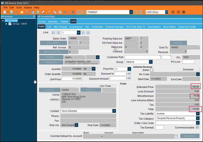

Packing Slip 1:
Ship all 10 items from one lot and one bin in a single packing line
Invoice:
Customer Charged Total: $ 110
Goods: $100
Misc Charge: 10
Total Items Shipped in Packing Slip: 10

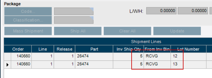

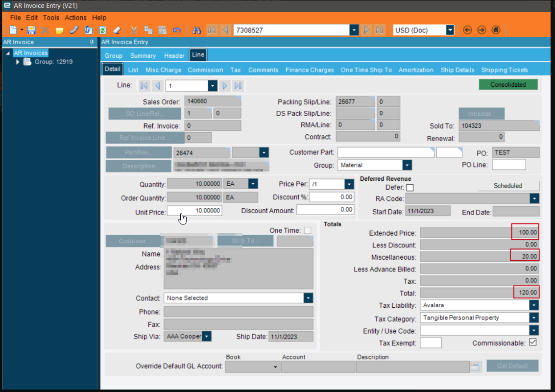

Packing Slip 2:
Ship 5 items from one lot and 5 items from another lot in the same packing slip.
(Can’t help how inventory is laid out)
Invoice:
Customer Charged Total: $ 120
Goods: $100
Misc Charge: 20
So same quantity if items shipped and part numbers in the same packing slip but hey we just made an extra 10 bucks… COOL “DESIGN”

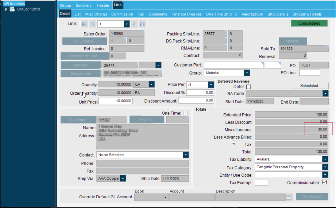

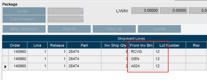

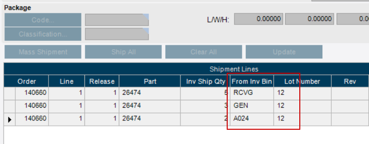

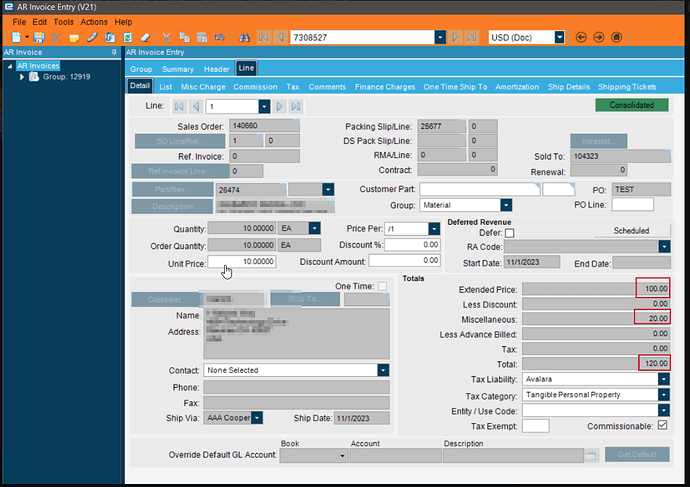

Packing Slip 3:
Ship all 10 items from the same lot but in different bins. 5 and 3 and 2 (warehouses are messy)
Invoice:
Customer Charged Total: $ 130
Goods: $100
Misc Charge: 30
Same quantity again but I picked from different bins cause warehouses in real life are messy.. I made a cool 20 extra bucks #GoProfits

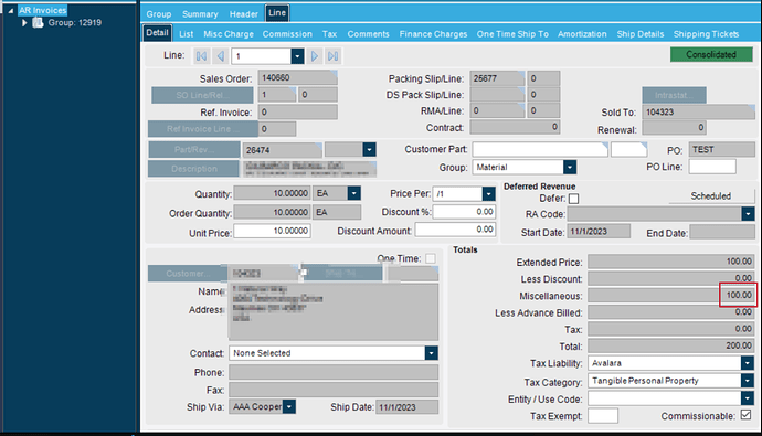

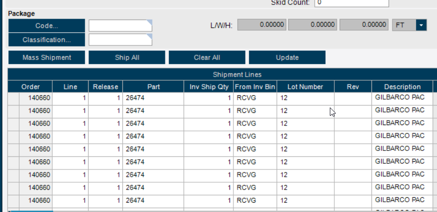

Packing Slip 4:
Ship all 10 items from the same lot and the same bin but in separate shipment lines cause now I know how to maximize profits #YEAH BABY #ImGettingAPromotion
Invoice:
Customer Charged Total: $ 200
Goods: $100
Misc Charge: 100
I shipped the same 10 items out of inventory with the same efforts in the same packing slip in the same shipping truck.
