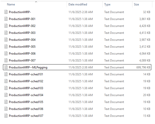

MLPegging log is hundreds of megabytes in size? That normal?
Multi-level pegging, of course.
We run it as part of MRP (not a separate process; not in a process set).
Does it just keep growing? It was about 500 MB a few days ago.
I don’t recall ever seeing it at all when we were on 2023.2 (or earlier). I see nowhere for adjusting its settings.
I’ll probably submit a ticket.
Your logging must be set to Append. It just keeps growing until you clear the file. We do Split on all logs so that we can archive based on dates. If you don’t need the logs Overwrite would keep the file the smallest. Append is the default IIRC.
No, it’s overwrite. The MRP logs are fine; they are fresh each day. It’s just the MLPegging. Now at 744 MB.

But again, if it were append the MRP logs would be MUCH bigger.

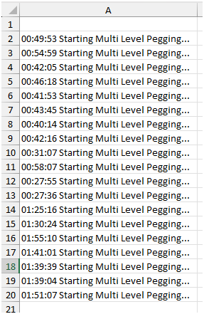

So there are no dates inside the MLPegging file?! Strange.
EDIT: This does match the time of our upgrade. 19 workdays since then and 19 occurrences of “Starting Multi Level Pegging”. (I did a macro to count the occurrences in 12 million lines of text…)

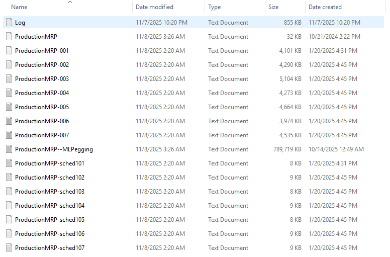

But the other MRP logs are fine; they overwrite. Here is the last set (Friday night); MRP logs have not grown since the pic from Thursday (Weds. night).
[That first “Log” file is for job auto close.]
Like I say, I don’t remember seeing the pegging log and I don’t really even want it. But if it exists, it needs to have some settings I can change.

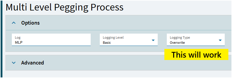

Multi-Level Pegging can be run separately from MRP, and in that screen there is a place to set the pegging log type.
I tested it an it does indeed overwrite if you tell it to.

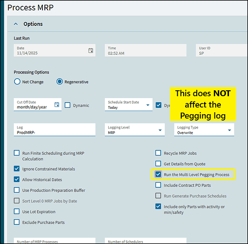

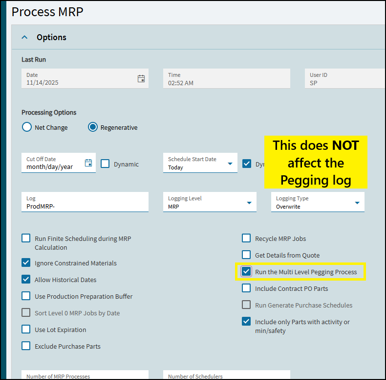

But I was using the handy dandy checkbox in MRP, and while that was a good idea before, it is now a terrible idea.
So what I have to do from now on is to
  • Uncheck the box in MRP
  • Create a process set with MRP, then Multi-Level Pegging
  • Run/schedule the process set
