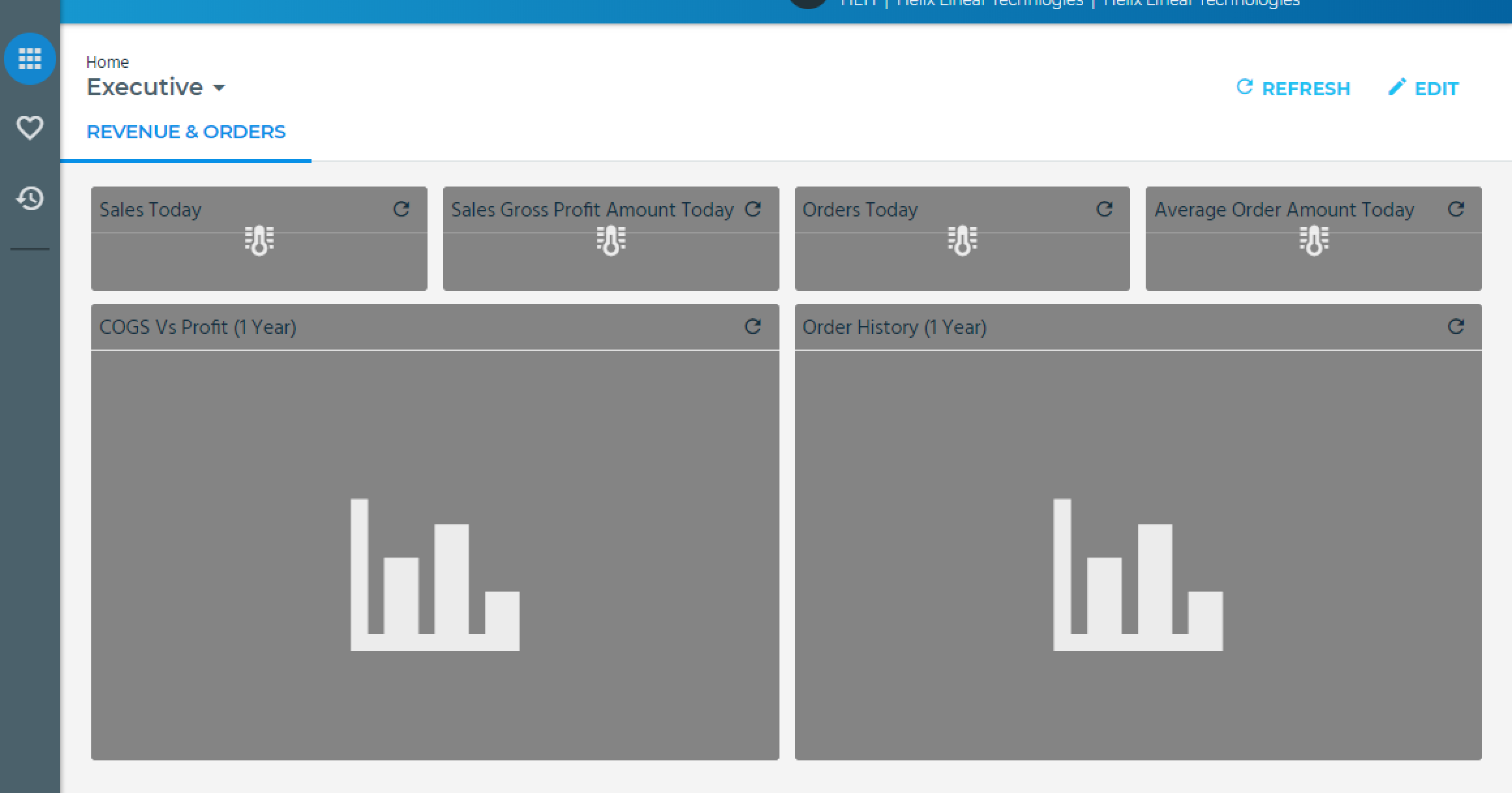

I’ve gone through the Application Help for Home Page templates and assigned rights to the Home Pages. I can apply the Executive Home Page to my account, but I get no data. Clicking Refresh has no effect. What am I missing?
Have you installed the Epicor Data Discovery module?
I didn’t set up this server, it is a new client I started helping last week, so I’m not sure if EDD is installed. I did check the licensed modules and Data Discovery is licensed and enabled. Is EDD something that I have to download from EpicWeb? I don’t see it on EpicWeb.
Ah, I see it can be installed within the App Server configuration. It is not installed. I’ll give that a try.
