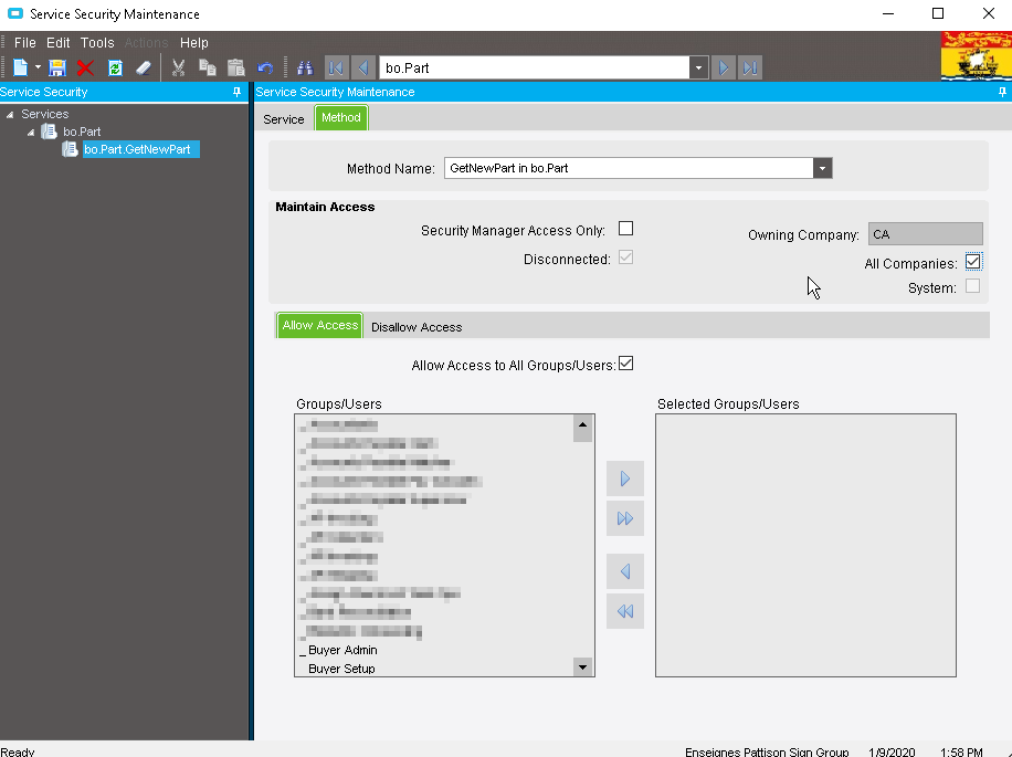

We did something similar and to prevent some users from adding new records we put security on the method so only the people allowed to create new part could and others could update or add warehouses.
