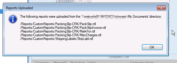

After choosing my “My Documents” folder and clicking OK, I get:
