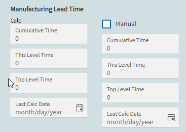

Do you run the Manufacturing Lead Time Calculation? You could use that.
Mr. John: Thanks for the suggestion - i did not know about that one.
It looks like a process that creates a file on the server? is that correct?
DaveO
It’s a process that calculates the manufacturing time and displays it in the part record.
Interesting - I did not know about that one.
I will dig deeper.
Thank you,
DaveO
Mr. John: I like your suggestion that would make life much easier for me.
I am trying to understand how the total factors in the Part Rev? It looks like the total is stored in PartPlant.TotMfgLeadTimeSys which does not appear to be associated with any Revisions. Our Rev’s can have large swings.
Any thoughts appreciated.
DaveO
I believe the functionality assumes you only have 1 approved revision with current validity dates. If you have more, I’m not sure how it would behave.
