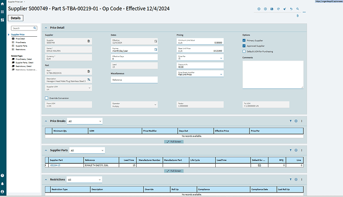

I am wondering where can we add the MOQ of a part? I see no space for MOQ in the supplier price list table…
It is link to the supplier and not to the part it self so it should be on the supplier price list table.
