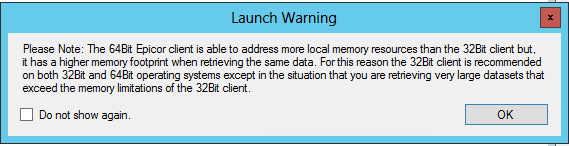

The standard line is that the 32bit client should be used by everyone unless there is a reason to use the 64bit bit client–which is why our client installer only installs the 32bit client shortcut.
The reasons to use the 64bit client would be if specific users receive out of memory error messages doing something client side (dashboard, Crystal report generation, etc), or there is a custom 64bit only assembly that is used client side that requires the 64bit client(which was the actual reason why we created a 64bit client back in the E905 days if memory serves.)
We warn users against using the 64bit client unless it is absolutely needed.
My experience is that the 64bit client is slower than the 32bit, but, I can’t provide you an actual reason why that would be true or even if it is actually true. Someone more knowledgeable than me (@josecgomez, @Bart_Elia, @Rich or basically anyone else really) could confirm/deny my experience with it with a technical reason. It’s possible that it’s all in my head as I haven’t actually looked at the metrics via UI trace or process monitor.
This doesn’t help you at all, but, that is the official answer anyways

The 32 Bit Client is a little faster and less resource intensive as compared to the 64 Bit Client primarily because it allocates and manages a smaller amount of memory. Out of interest, I just loaded up both a 32 and 64 Bit Client version of 10.2.200.13 and then viewed the memory allocation via the Windows Task Manager. There are several different counters available for Memory and all of them were 25% to 30% less for the 32 bit client.
The actual source code of Epicor.exe and Epicor64.exe is the same - we just compile Epicor.exe for a 32 bit environment while Epicor64.exe is the same code compiled for “any” environment.
As Nathan notes, the Epicor recommendation is to generally use the 32 Bit Client unless you have very large amounts of data or have a need to interface with 64 Bit DLLs.
The Server should always run as a 64 Bit environment as the Epicor Server memory footprint can become fairly large.
