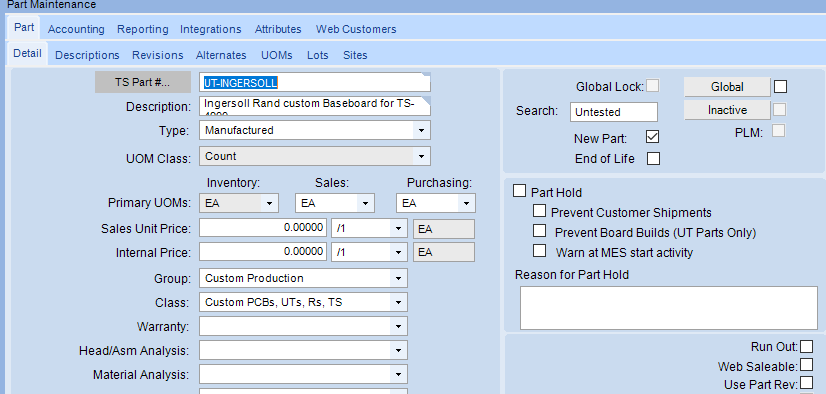

Check the parts in part maintenance, there’s a setting there “Use Part Rev” that needs to be unchecked to pull from the sales order.
From Field Help:
Use Part Rev
Select this check box if the Material Requirements Planning (MRP) should use the highest (most current) revision available of the part. If the check box is selected, an entry of the part number automatically specifies the most current revision.
If you clear this check box, you can manually create demand in MRP for different revisions of the same part, and the Epicor application honors the different revisions.
This option does not apply to requirements for stock. This check box has no effect if you do not use MRP.

@timshuwy it sounds like if we uncheck “Use Part Rev” in Part Maintenance it will force MRP to pull the rev from the sales order in the case that we have more than one approved rev. Is my understanding correct?
If we want to test this out I’m thinking I can go to this one part and change this setting then wait for MRP to run and verify it now uses the rev on the sales order. Am I on the right track?
@embedded, Yes you are correct IF the sales order is Make Direct.

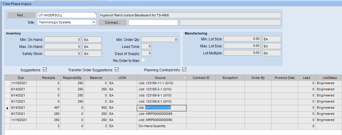

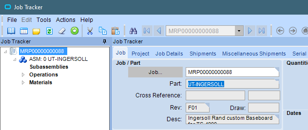

@timshuwy We tested this out but it didn’t work. Please see screenshots below.

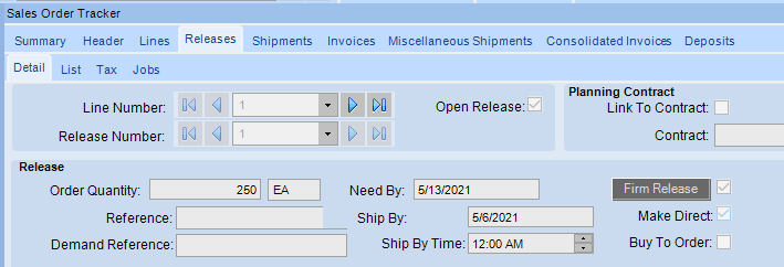

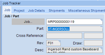

We verified the Sales order was make direct, and we verified the part had Use Part Rev flag cleared(on both the parent and child part). We then reran MRP but the MRP suggestions for the child part are still the wrong rev(not the rev on the sales order).
Please note the sales order is for the parent part that we sell(TS-INGERSOL Rev D), the MRP suggestion if for us to build more of the child part(UT-INGERSOL). The way we use revs is the child part rev corresponds to the parent part rev(so rev D child rev goes with rev D parent). We’re wanting the MRP suggestion for the child part to have the correct rev(the same rev as the parent part on the sales order). This leads to another question(possibly the source of our problem), a parent part calls out the child part in method tracker but doesn’t call out a rev. How does it know what rev to use(for a child part)?
