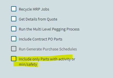

I think the WI EUG meeting with @timshuwy was about not processing parts without demand and the new Include Only Part with activity or min/safety checked.
If you have a lot of parts without activity and no min/safety, then you’ll likely see the benefits.

@Mark_Wonsil is correct… you need to check this box he illustrated in order to gain the faster speed.
Note that not everyone has an amazing speed increase. some have only 50%… a few have had 10-20%… one had 99% (7 hrs to 4 minutes). This is ALL dependent on the makeup of your data structures in the BOM.
ALSO NOTE that this little switch that Mark mentioned, is available in Generate PO Suggestions. We have seen even bigger improvements in speed here.
Please report back your results with this switch flipped.

Preliminary results are in, with the checkbox enabled being the only change it went from 3 hour average over the last 4 days down to 35 minutes. Awesome! Still going to save the part dtl records and compare to the regular run.

Is it? Do you have this checked?
Check that box Jason make a huge difference for us in 2023.1 when we first tested it
I believe it was added officially on 2023.2

I believe you. The way I understand it is like this:
Let’s say it takes 5 computer “cycles” to check to see if there is a min/safety or demand, and it takes 100 computer “cycles” to process a part for MRP.
The gamble is that more parts will use only 5 cycles instead of 100. If a part has a min/safety or demand, then it will take 105 cycles to process a part: 5 to check plus 100 to process MRP.
I am guessing you have very few “dead” parts, or most parts have a minimum/safety stock set.
