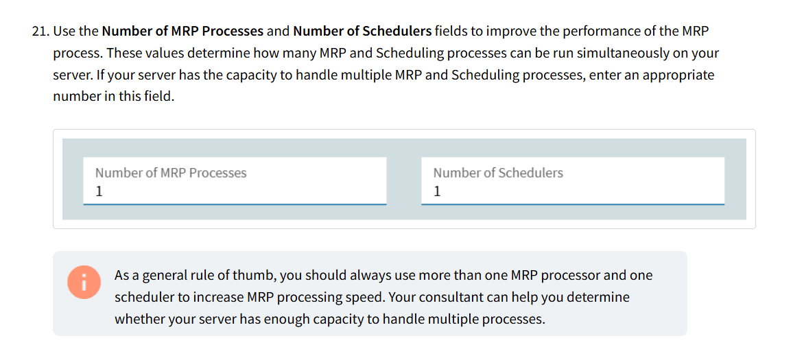

You can exclude items without activity and there’s a prompt for number of MRP processes/schedulers…maybe adjusting that might help? I think ours runs Net Change most of the week with Regenerative done once or twice.
Screencap of helptext inside...
Hi John,
We have it set to 3 MRP Processes and 3 Schedulers, I believe this is the max for cloud, but I could be wrong. I’ll look into the exuding items without activity setting.
