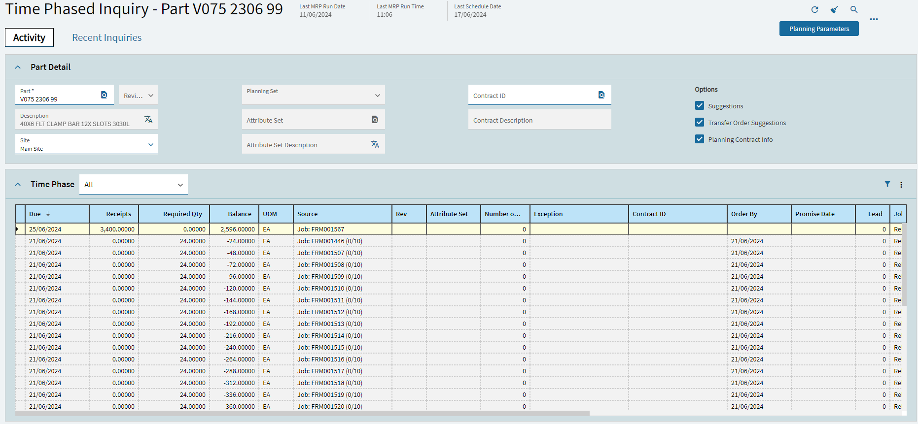

The V code has demand against it thats throwing huge negatives:
I go to my “C” Code and ive got only 1 demand in associated with 1 of the V code jobs, and then a MRP job for a date miles in the future in turn giving me the negatives on the “V” code im seeing

MRP Has Run, its not changed my demand on the V code
No new job suggestions in the JSM screen
Time Phase:
Its created an unfirm suggestion on the C code
Time Phase:
Its suggesting that on the 18/09 to make the material part, for the V part thats got demands on the 21/06
