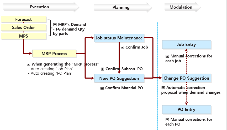

My company is seriously considering whether to run an MRP. If the MRP process can be operated as it is, of course, it will bring good results to the company(Inventory reduction, delivery time, etc.) Unfortunately, each company has its own business process, so there will be some parts where it is difficult to operate the MRP process as it is.
Epicor’s MRP process I sketched out is as follows. But I have one question.
MRP proposes Job and PO. Can’t MRP only offer PO?
So we did not generate the MRP process, only Generate Purchasing Suggestions. However, the problem with doing so is that it does not take into account FG’s stock, but only considers the quantity of Jobs. In other words, if you need 100 FGs and you have 60 FGs in stock, I would like to suggest the quantity of RMs required to make 40 FGs. This is the basic logic of MRP. However, my company wants to manually put the job separately. The reasons are too many such as that the forecast is not accurate, that the job is directly outsourced, and so on.
So, I am wondering if it is possible to set the MRP so that it proposes the quantity of RM considering the FG stock quantity but does not create a job.

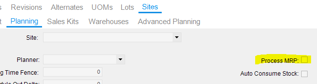

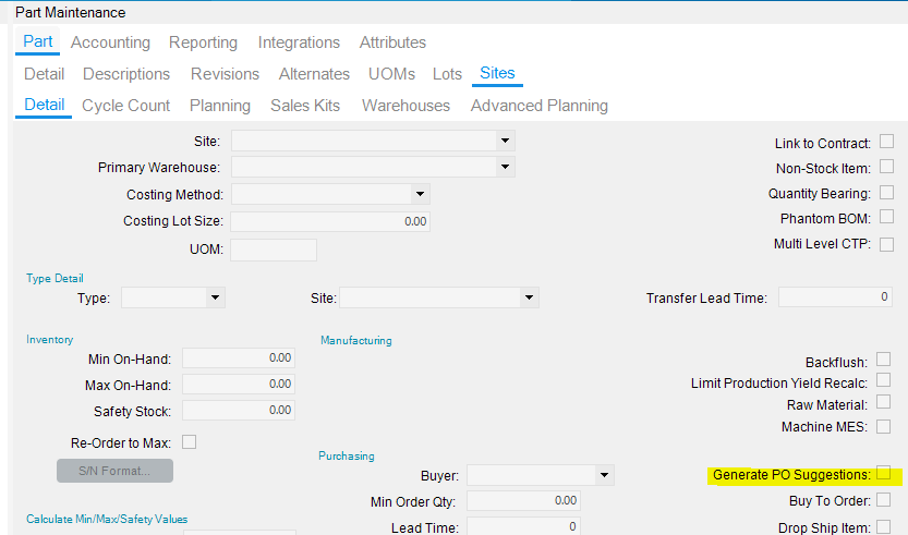

Do you want MRP to make some jobs but not others? For example, MRP should not touch finished goods? Then mark those parts as “Process MRP = false” in the PartPlant (sites tab of Part Entry). Also I would think you also want to mark it as “Generate PO Suggestions = false.”
It’s really, really normal to be really finicky about your finished goods jobs and helicopter-parent those every day. Those are the core and you have to baby them. Then use the system to do the rest.
