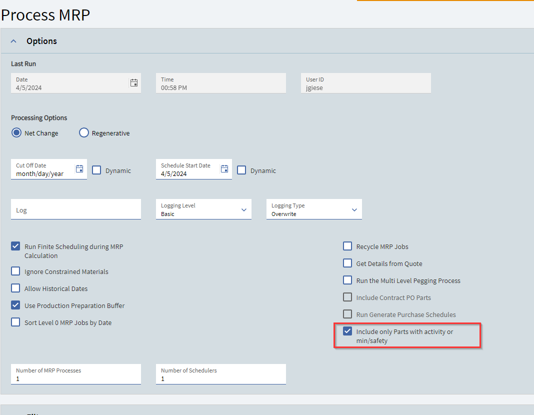

Edit: 2024.1 auto checks this box
Tested 2023.2 without that checked the first time. With it checked 2023.2 was 5 minutes.

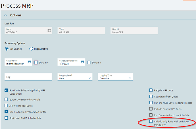

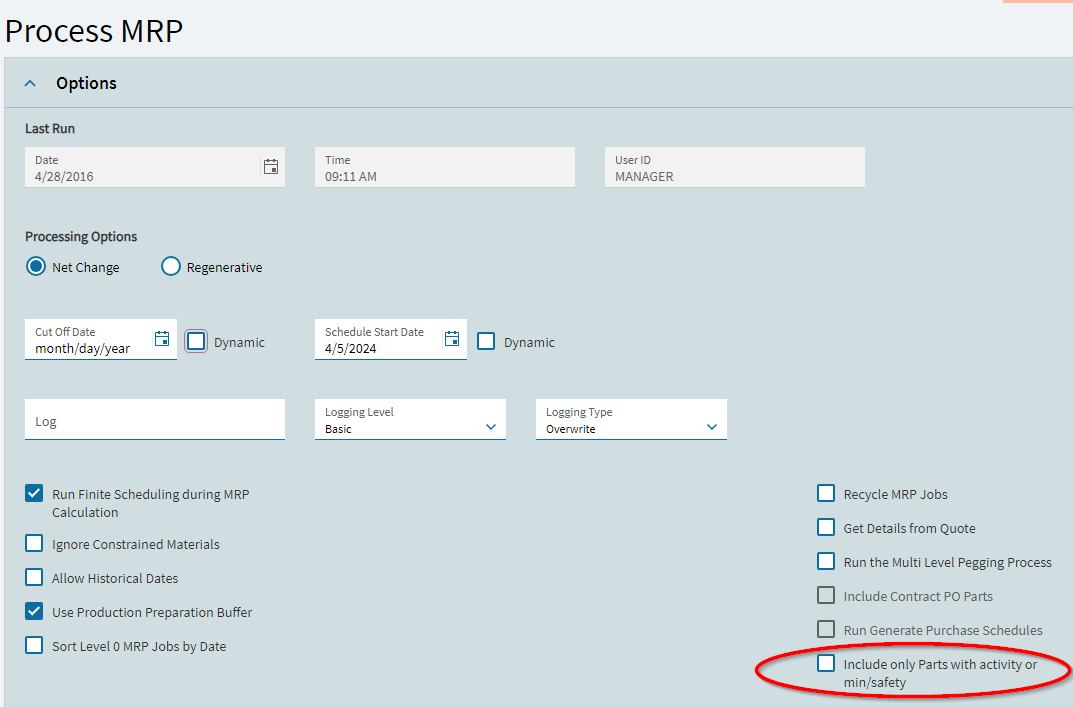

How to access it? It is on both the Generate PO Suggestions and Process MRP.
To get it to work, you simply need to check the box labeled “Include only POs with activity or min/safety”
Note that this checkbox is ONLY AVAILABLE IN THE BROWSER VERSION… you cannot get access to this from the old smart client screen.
What Does It Do? well… it does exactly what the label says: When you check this box, it will put one additional filter onto MRP to only look at parts that have DEMANDS (Orders, JobMtl, Transfers), or parts that have Min/Safety quantity.
WHY does this work? Well… before we enhanced the software, MRP would select ALL the parts, then, one at a time, it would examine the part to find out if it had any demands, then it would look for min/safety, and if nothing was needed, then it would go to the next line… otherwise, MRP would process… Because of the new pre-filter, it becomes much more efficient because we only need to examine parts that need examined.
END RESULTS: MRP runs faster, but returns the same suggestions.
