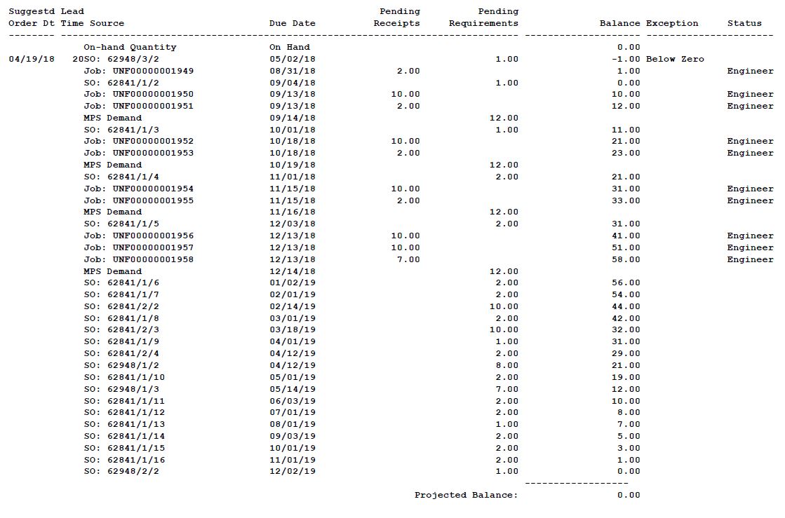

Shown below is a time phase screen that clearly illustrates the improper functioning of MPS. Still wondering if anyone else is seeing this in their system.
The only issue I see is the -1 below zero exception, which Vantage may not have a way around, based on the suggested order date being in the past which would imply a lead time that cannot satisfy the pending requirement of 1 on 5/2, a date that’s also already passed. Looking forward it appears that the balance is managed down to zero at the end of next year, which may or may not be correct based on your max/min/safety settings for the item. Apologies for the simplistic reply; what specific improper functioning is visible in this printout?
What is driving the 27 piece jobs due on 12/13? There is no unmet customer demand for that date, and the MPS indicates that a 12 piece job should be created. Why is the system adding additional production to meet demand that is not needed until 9 months out? Nothing here that I can see should do that.
Think of it this way. If the material for this part cost $1,000,000 a piece, you probably don’t want to carry that much inventory for a full year. We have several parts in our building for which this is not that dramatic an exaggeration of inventory costs.
There are definitely some quirks in the way MPS integrates with customer demand. I’d love it if someone could accurately explain how the heirarchy of order creation occurs in Vista. We all know what we WANT it to do, in theory we all know what it SHOULD do, but what on God’s green earth is it actually doing?
No, it is not. It is building all of the 2019 demand per the 2018 MPS entry. That is the behavior that does not make any sense.
Our plan is to build 12 pieces a month of this item for the last 4 months of 2018, and let the system plan jobs for 2019. Can’t get it to do that. It keeps planning all of 2019 to the final MPS date of 2018.
