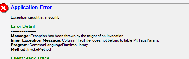

I’m working on printing MtlTags from a UD form and am almost done thanks to this awesome post:
How to: Build a custom form to print job-related documents and tags without logging in to a job:
However, the one thing I am having trouble with is the TagTitle. If I try to set it, I get the following error:
Is there a way to set this that I am missing or is there another parameter I can set which will determine which of the preset titles will be printed on the tag? Any help would be greatly appreciated.
@TDray I think you need to set TagFormat to the PartTran transaction type you want to simulate.
Thank you Greg. That was it. I had set the TagFormat to “MFG-OPR” and was getting “WIP” as my title. I changed the TagFormat to “MFG-STK” and “STOCK” was my new title. Appreciate the help greatly.
