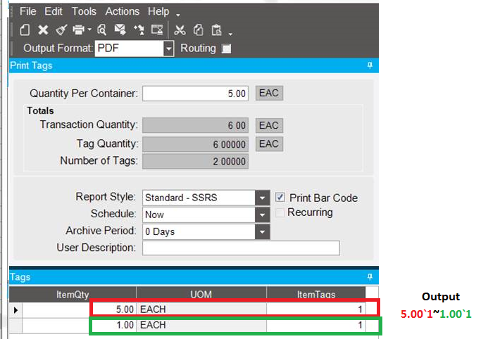

I was just wondering if somebody has done something similar for auto printing mtl tags when doing a labour transaction.
Basically I’ve ran a trace log and the report parameter “ItemTags” is the only report parameter I seem to be having a problem with. What I am trying to achieve is to be able to replicate the output 5.001~1.001 like shown below the main variant being the division of the Transaction Qty by the parts per container. But unfortunately no luck so far as I get a parse error - Works fine for 1 offs thought .

I got it. Thank you your code helped. I got it to run through the standard Data directive and what I was missing is that a string with 1.000000 does not parse to 1 by doing int.tryparse you have to first do double.tryparse then int.tryparse. The Code of Decimal qtyPer then in the ItemTags converting that to string was what made me think about my conversion. Thank you So much.
