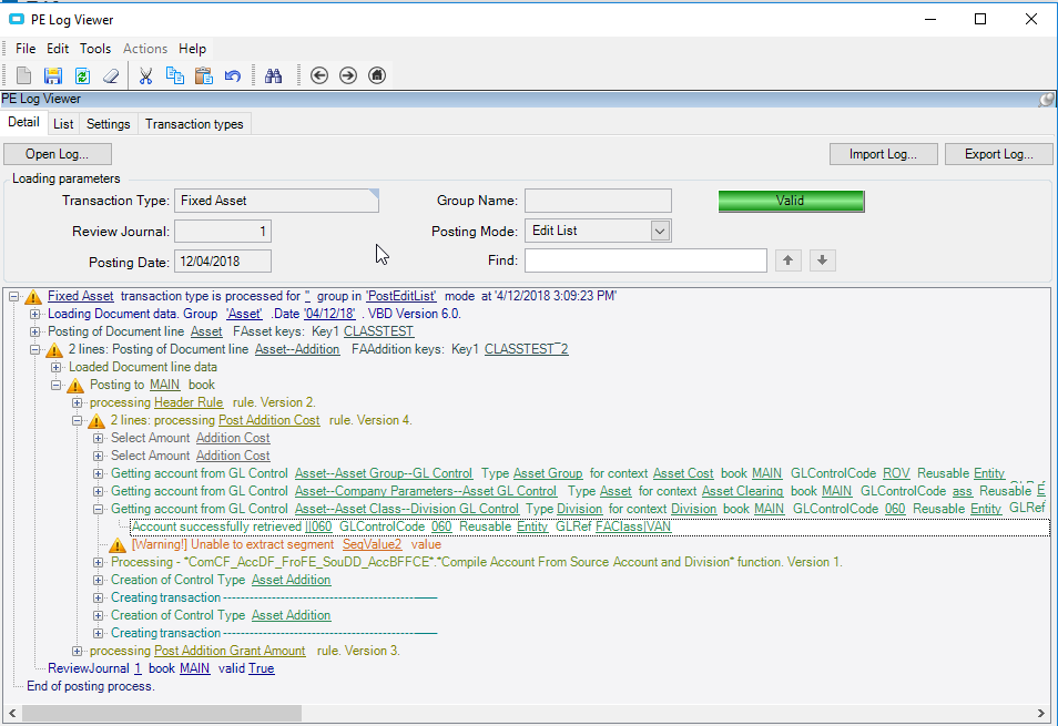

If you are feeling adventurous you can turn on the Post Engine logger and look for clues in there.
Under Financial management -> General Ledger -> General operations -> PE Log Viewer.
Turn on the log for the transaction you have an issue with (see the transaction tab of the PE Log Viewer). Run the posting again (I think you can also run the validate process from the review journal). This will create a log you can open and dig through. Look for the details of where the engine is trying to find an account but gets nothing.
Here what a log with an error looks like.

Thanks Brett, I really think this would help me ID where the problem is.
However, after enabling the AR Invoice (heck I even enabled ALL for the company in question) and logging out and back in and attempting both a repost AND revalidate in the Review Journal, when I attempt to bring up the PE Log Viewer I get the error message: ‘Impossible load information from PE Log’

Ok, tried it again and it generated a log… but everything I check for GL controls looks ok.
We would expect the GL Control used to be based on the Order Line/ Invoice Line Product Group, but I don’t see that being evaluated in the log. but this is my first time trying to read something like this. I have attached the log in case anyone can correct what I am missing.
