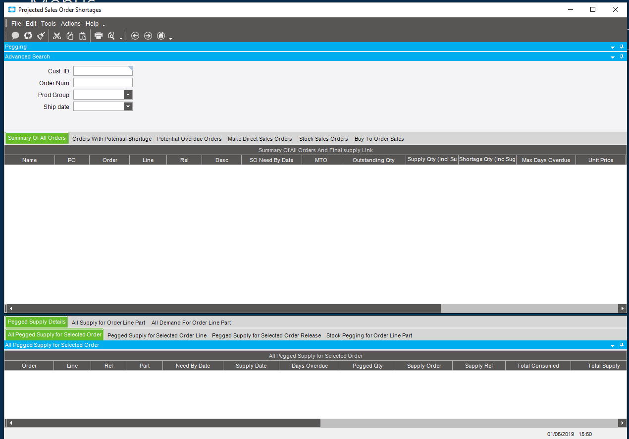

a good std dashboard tracker to check this process

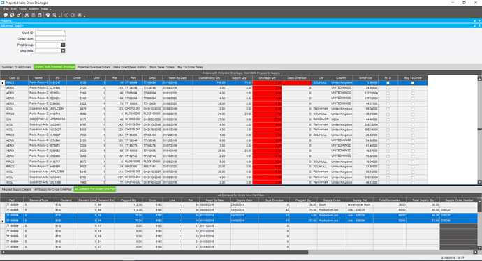

I am getting inconsistent results with the Projected Sales order shortages Dashboard. Specifically with the demand links for supply pegging to a purchase order when there is sufficient stock on hand to cover the order. The below order is for a purchase item shipped from stock but is getting pegged to the next arriving PO. Currently we have (14) pcs of that item in stock and should not show as a potential over due order.
Based on all the documentation I have seen Multi level pegging should be using stock on hand first if there is enough to fulfill the order then peg to Open PO’s / Jobs.
Is there a conversion that needs to be run somewhere to fix the issue?
