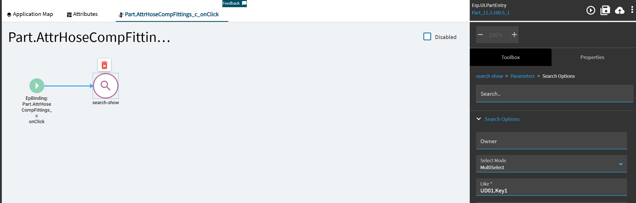

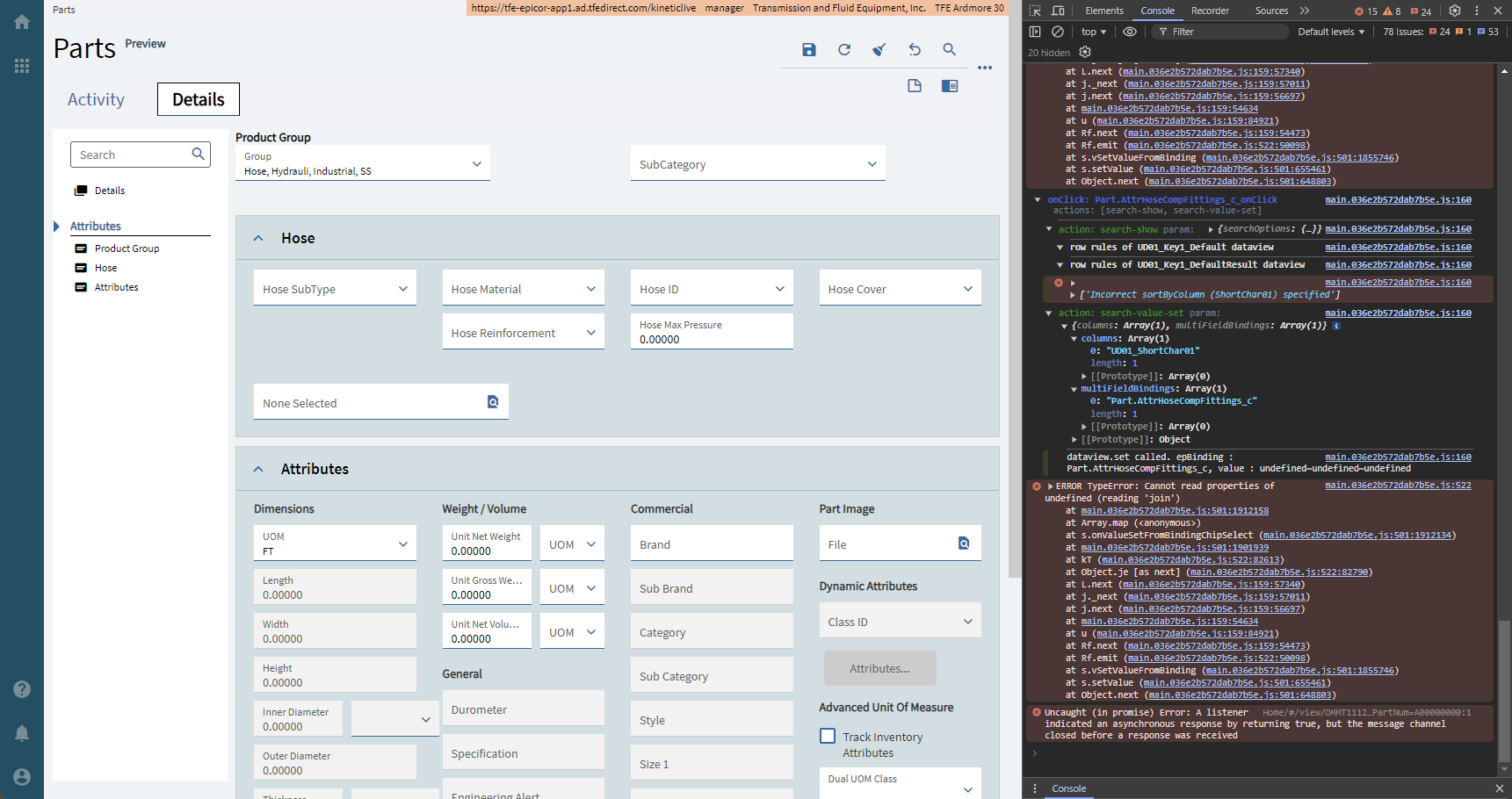

Here is the setup and result.

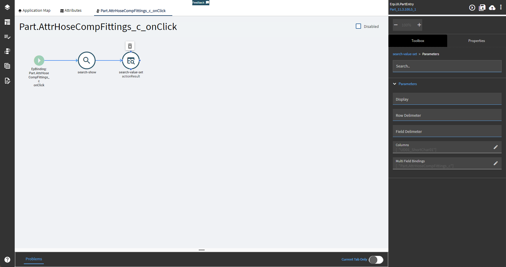

What are your Parameters under the search-value-set?
Hi David, I believe that’s in the first image, no?

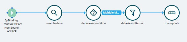

OR… the data-view condition allows for “OnMultipleMatch”… so you might be able to add your dataview-filter-set and row-update after that… so your event would look like this:

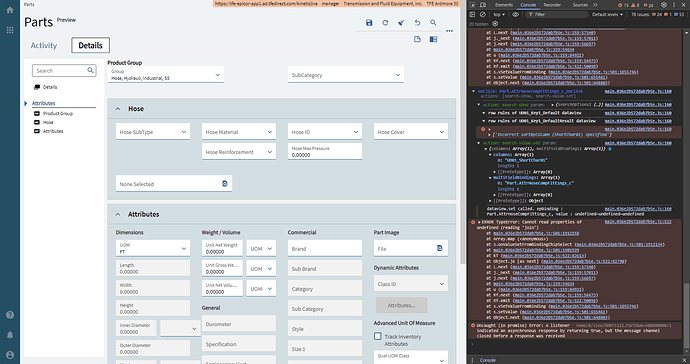

I have searchResult returned with multiple entries…
That seems correct. Now I just want to insert one value from each of those rows, ShortChar01, into the field value for compatible fittings. I’m struggling with the suggestions. DataViewFilterSet, just seems to filter down the dataview, not add them to the destination, and feels like a redundant step, since I have the data I need simply in the searchResult view. Any suggestions?

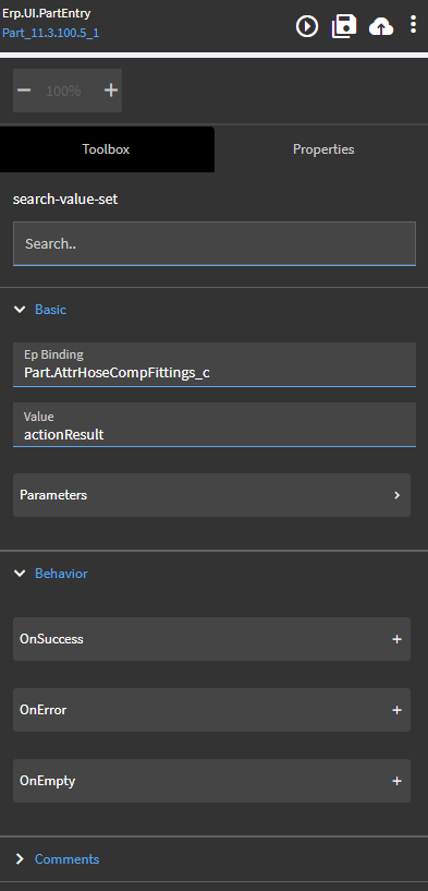

Actually found a good working example of this search chip in the Stock Status report filters. Mimicking that got me a fix. Using a search-value-set works and is straightforward.
