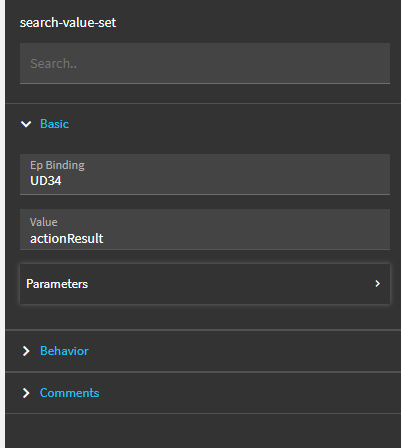

I have a button wired up to show a search which works fine.
It also works fine when I wire the On Success/Search-Value-Set to a single binding.
I’m struggling to figure out how to set it to multiple bindings.

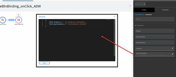

This is what I currently have:
I’ve tried a number of different combinations of the data in the JSON editor including:
    "{UD34.RelQuote_c}" : "{actionResult.QuoteNum}",
    "{UD34.QuoteDueDate_c}" : "{actionResult.Date10}"
    "UD34.RelQuote_c" : "{actionResult.QuoteNum}",
    "UD34.QuoteDueDate_c" : "{actionResult.Date10}"
    "UD34.RelQuote_c" : "actionResult.QuoteNum",
    "UD34.QuoteDueDate_c" : "actionResult.Date10"
    "RelQuote_c" : "{actionResult.QuoteNum}",
    "QuoteDueDate_c" : "{actionResult.Date10}"
    "RelQuote_c" : "actionResult.QuoteNum",
    "QuoteDueDate_c" : "actionResult.Date10"
    "{UD34.RelQuote_c}" : "actionResult.QuoteNum",
    "{UD34.QuoteDueDate_c}" : "actionResult.Date10"
I’m sure there’s more combinations I’ve tried, but clearly it’s not working, lol.
Couldn’t find much in the documentation.

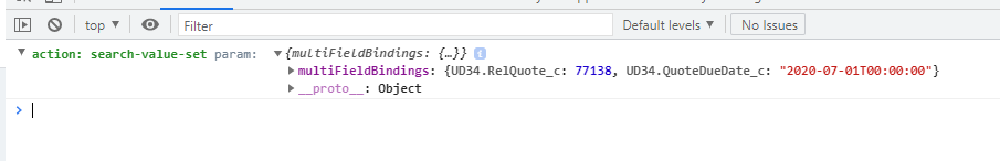

One step closer.
I see the data coming back, but it’s not binding it to the field.
    "UD34.RelQuote_c" : "{searchResult.QuoteNum}",
    "UD34.QuoteDueDate_c" : "{searchResult.Date10}"
