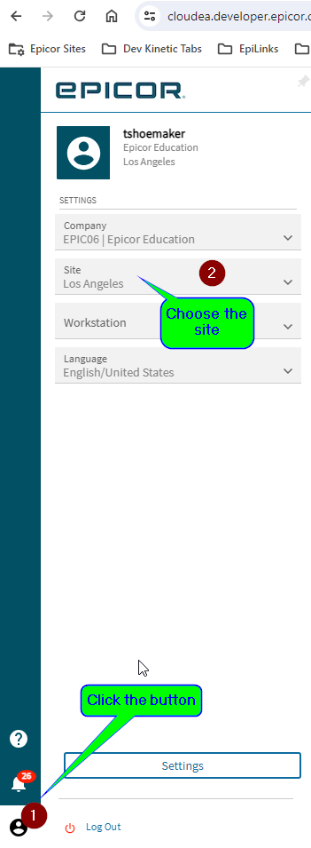

Tim, how do you change sites in Epicor? We would need to be able to order parts from more than one site in the same order, can we do that?
yes, you can change sites, and yes, you can combine POs from more than one site. To change sites, ONCE you have created the site, you can simply tell the system which site you want to be in. Note that SOME transactions are site specific… for example, when you are multi-site, and you are in Site 1, you cannot adjust inventory in Site 2. You cannot edit JOBS that are in Site 2. BUT you CAN create POS for either site 1 or site 2.
