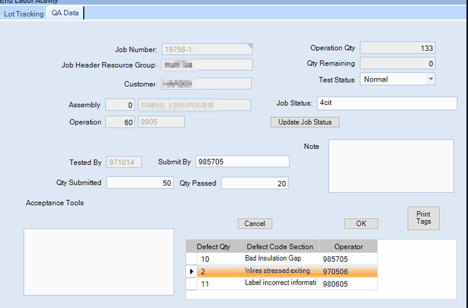

Yes and no. We have multiple opportunities per operation. If an operation is tin and solder wire, but there are 100 wires per assembly there are 100 opportunities for a defect per assembly for that operation. This does not get sent to scrap with reason codes, but it could. I write to a table for analysis and I add a rework operation for the failures to the job. The grid can grow as needed and the Defect Code has thousands of selections.
