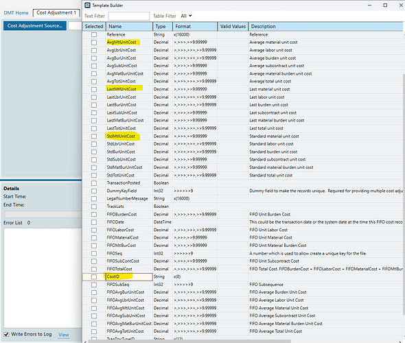

DMT is NOT an option, simply because there is no DMT type for PartCost.

Agree. I was just saying there seems to be a DMT for PartCost.

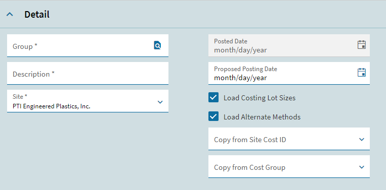

In costing work bench, In a new group, you copy from one Cost Site ID:
Then at posting time, you post to the new Site Cost ID.

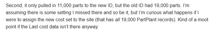

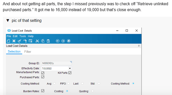

  • It does not automatically copy 100% of the rows. My experience was the best I could do was for 16,000 of 19,000 parts. (First pass was 11,000; pics below of those posts.)

  • Even if you wanted to live with all of that, how would you rectify the errors? There is no DMT for it. Yes, there is a Cost Adjustment DMT, but Plant is a required field - it won’t let you modify an unassigned cost set.

Screenshots:
First pass
Second pass
