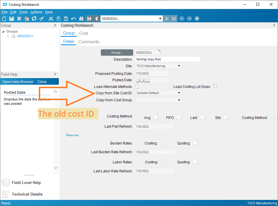

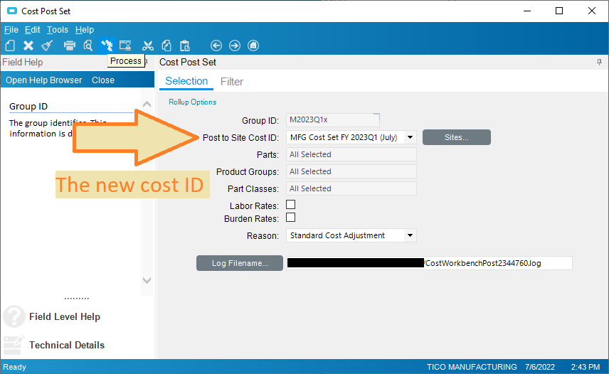

What I did:
(Loaded Cost Details - not shown)
And post it.
(I think this is supposed to say “Post Cost Set” not “Cost Post Set.” :rofl:

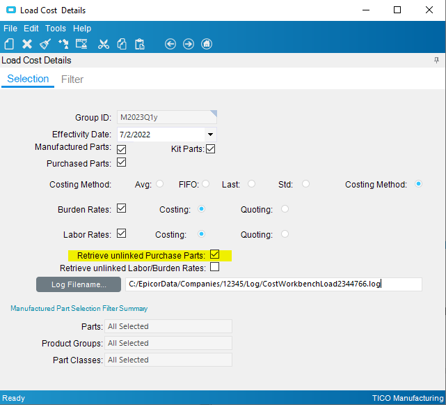

And about not getting all parts, the step I missed previously was to check off “Retrieve unlinked purchased parts.” It got me to 16,000 instead of 19,000 but that’s close enough.
pic of that setting
So the procedure as I see it for moving ALL costs from the existing set to a new one is this:
  1. Make a BAQ of the PartCost table. Download all of the parts for old Cost ID.
  2. In Site Cost Maintenance, make a new Site Cost ID. You can set the primary site already; this won’t hurt anything. A later step will actually link the two.
  3. In Costing Workbench, make a group; use the current cost set (not the new one) for the “Copy from Site Cost ID”
  4. Also in Costing Workbench, go to Actions > Load Cost Details. Be sure to check the setting of “Retrieve unlinked purchased parts.”
  5. Wait till the process is complete
  6. In Costing Workbench, go to the Cost tab and then search and return all purchased parts and all manufactured parts
  7. In Costing Workbench, go to Actions > Post. Then change the Site Cost ID to the new one.
    a. I unchecked Labor and Burden rates here since I am not updating those. YMMV.
