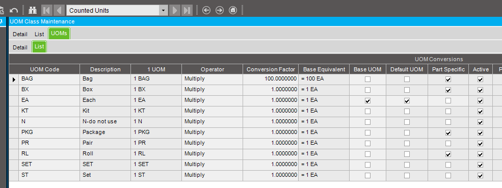

Can you post how the UOM Class is set up?

EA is the base UOM and we’re trying to use RL (Roll) and then define a Roll on the part to be 50 EA.
