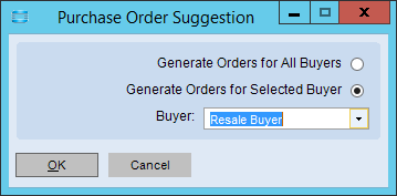

Elisha, when you click Generate from the Actions menu, there is a dialog box that pops up. In this box you tell the system to generate purchase orders for all buyers or just the current buyer.
