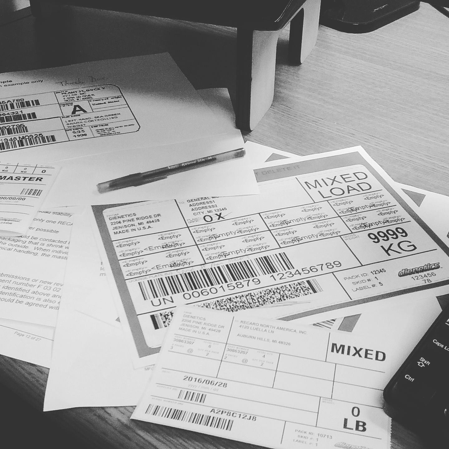

I did so many Labels and Printers, AutoPrint, BAMs and even Manually Code like Chris. It depends, perhaps you can use the “Resource Printer” Maintenance to redirect certain Operations to certain Printers… Perhaps you can create multiple Workstations and use AutoPrint?
The goold ol’ days of Barcoding…
