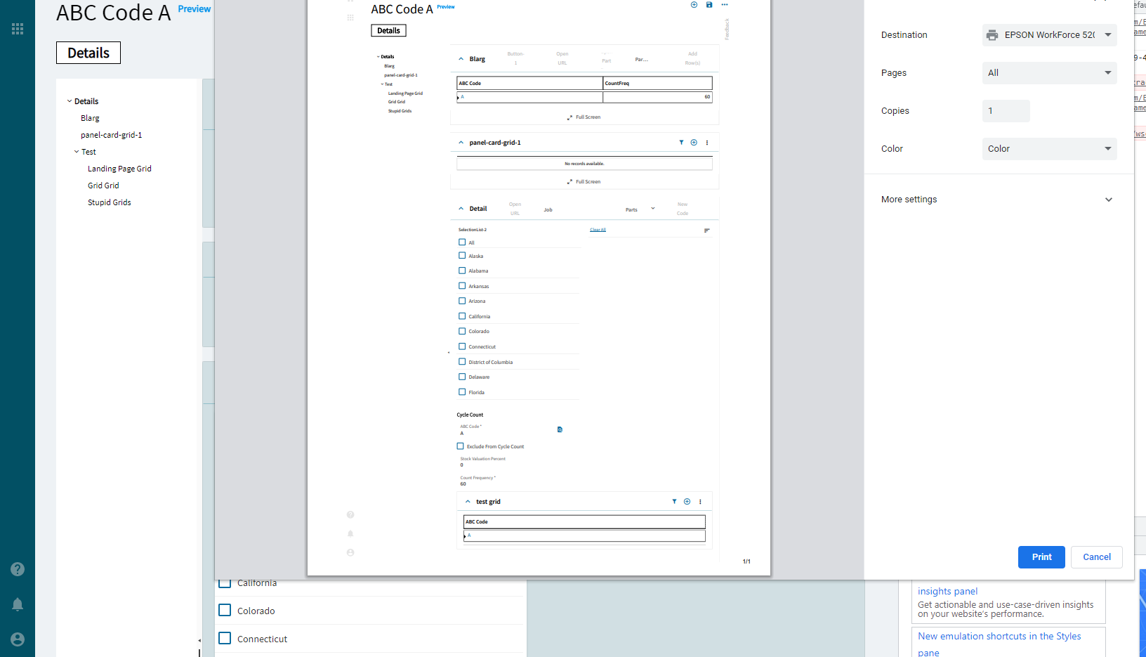

The best you’re gonna get is maybe to bring up the print dialog window by hijacking some expression field like so:
Which brings up this:
I suspect that’s not what you had in mind, though?

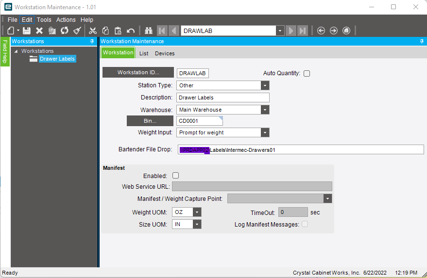

We added a Bartender File Drop location into the workstation UD file.
That way all bartender labels are processed thru that single directory on the server. We have a BPM for a workstation that has two different size labels and the BPM checks for the correct size and directs to one or the other printer.
