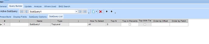

Haven’t gotten anywhere near testing anything yet. I am trying to follow the steps exactly as they are laid out in the training link I shared. The very first step creates a CTE query, but I cannot save it. That’s where I am getting the message that I need a top level subquery.

I followed the instructions exactly as indicated in the training, and that first CTE BAQ is very simple. Just eight steps. I just cannot save it. Not sure how I can be doing anything wrong?

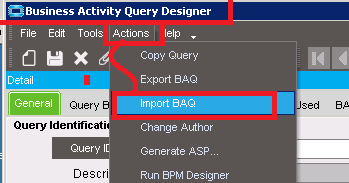

How do I use the sample you provided? How do I open the file to get it into Epicor?

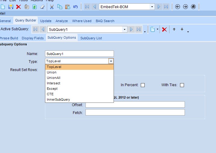

The BAQ is looking for one subquery to be type toplevel.
You can change the type on the SubQuery Options Tab.

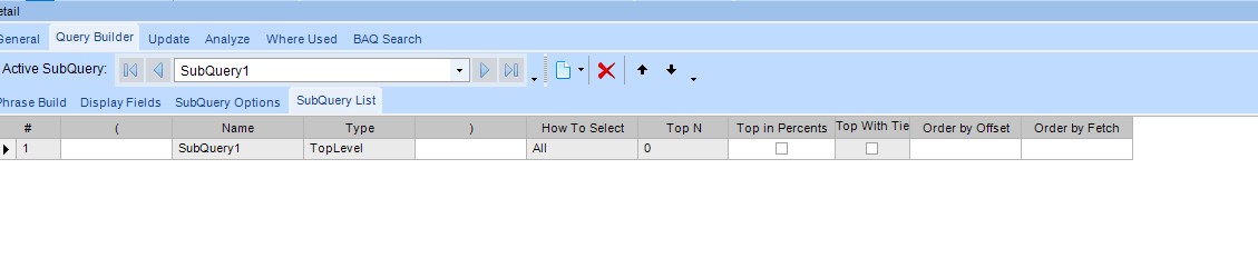

Posting a picture of where you are, helps us help you.
The training does not say anything about creating a top level sub-query. Guessing if I change the first subquery (CTE) to top level, I will not get the desired results?
Should be able to import to BAQ Designer

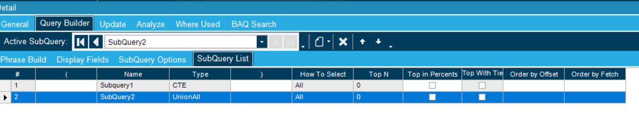

To do a CTE query, you need three subqueries
- CTE
- UNIONALL
- TOP
They need to be in the above order to get the data you want.
- CTE is the “seed” query that gets the first set of starting data
- UNIONALL gets the balance of the data and joins to the CTE
- TOP shows the results of the CTE. In this top, you can also join to other tables to get additional data that you may need.

Yup… you are correct. Once you have a CTE, you cannot save. BUT… you can do this:
- create a TOP query called “cte1” that will eventually be your CTE. See the results. Change to a Inner-Subquery
- Create a new Top called “Union1” that will eventually be your unionall query. Build out the next layer. Make sure that all your fields are the same types (as required by Union all). Test to see results.
- NOW change the first query to CTE, and the second query to UNIONALL.
- Create your Top Query.
If you do it this way, you can save along the way (until step 3).
