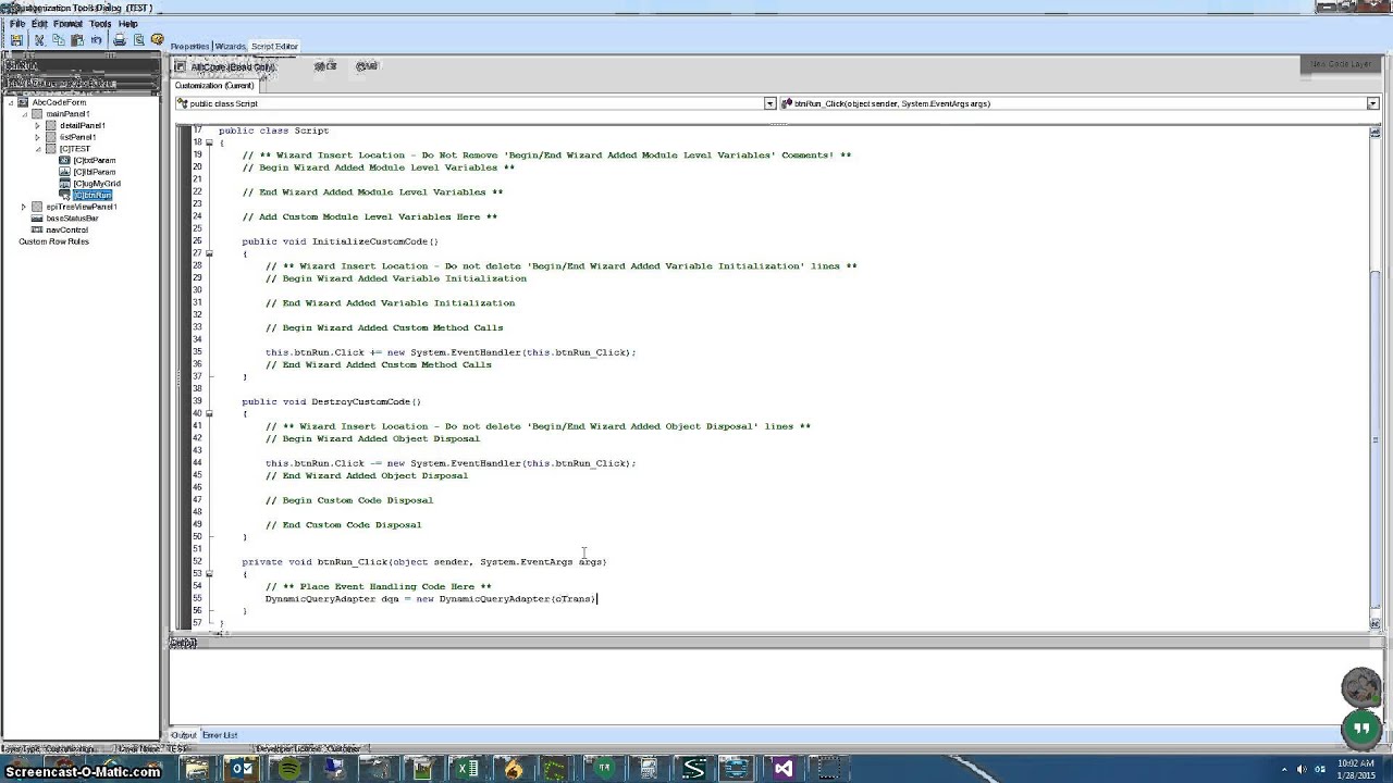

	private void TruckPackButton_Click(object sender, System.EventArgs args)
		DynamicQueryAdapter dalps = new DynamicQueryAdapter(oTrans);
		dalps.BOConnect();
