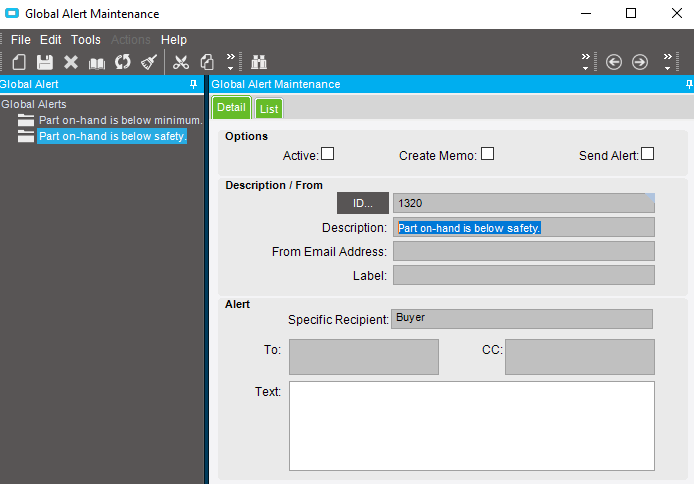

You can use the base functionality of send the email notification to specific user using global alert.
If the part goes
  • Part on-hand is below minimum.
  • Part on-hand is below safety.
This may be checker before initiating backflush
