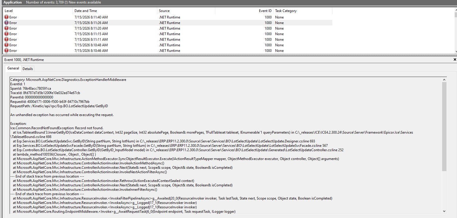

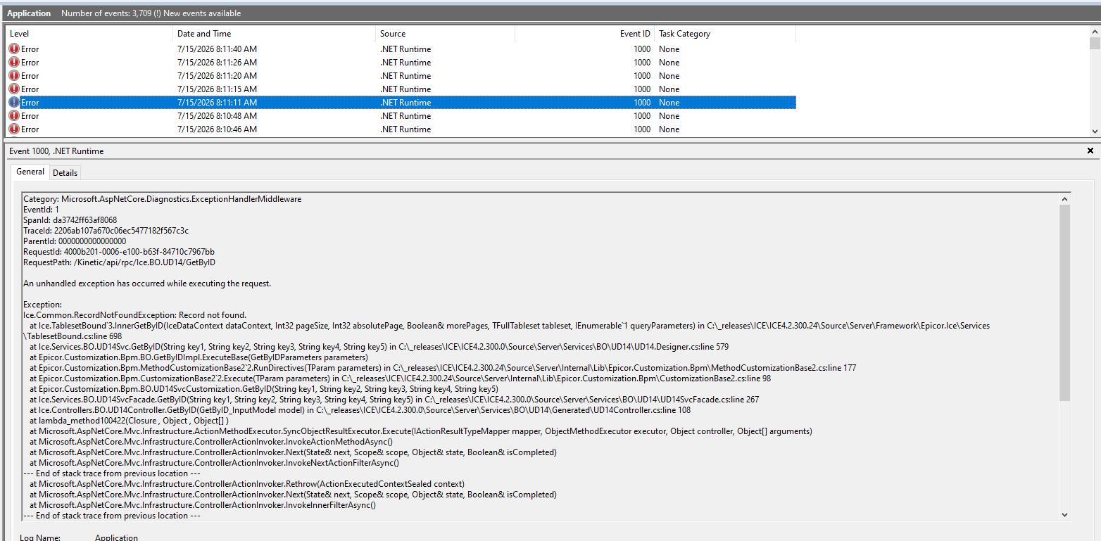

We recently noticed a large number of .NET errors in our server’s Event Viewer, and they appear to be coming from multiple BO GetByID calls. For example, some are originating from various UD tables, while others are coming from Epicor BO calls.
In this older post, @hkeric.wci Haso mentioned that this is an Epicor-related issue caused by their migration to .NET Core and that the errors are harmless.
Does anyone know if Epicor has come up with a solution for this yet? If not, is there a recommended workaround? Would it make sense to wrap the GetByID calls in a try/catch block?
Below are some of the errors we’ve been seeing:
You should just ignore it.
A RecordNotFoundException is the 404 of GetByID. How would I know https://google.com/switchtobing doesn’t exist unless it tells my browser? Catching the exception in a BPM (even if possible) would be Google not sending back a 404 page, leaving my browser to spin around waiting.
It might be annoying they’re verbose about logging it, but it’s hard for them to determine who wants what exception logged under what circumstances. I’m fine with that, rather than it being ignored like I do in my code… sometimes. :eyes:
