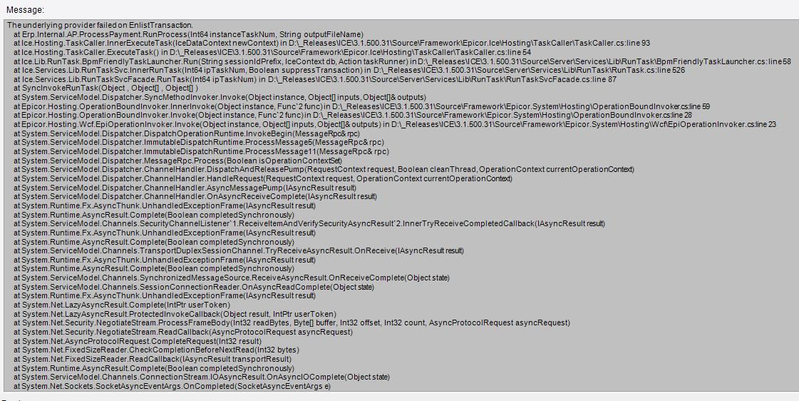

Just for the record I get a similar Issue when using “Generate Only” on IEx AP ACH Payments. Everything else works besides the Task Agent creating the ACH.txt file “The underlying provider failed on EnlistTransaction.”. NO DTC Enabled. Everything else works. ACH Works when I do it on Client vs Generating it on Agent.
Just thought id share =) might be related.
I only have the out-of-the-box Basic Local DTC just like on a Fresh Windows install
Should RPT Servers be Network DTC instead of just Local?
Mine’s just Default as-is out of box Windows.
It could all be related that Task Agent does have Max Concurrent Tasks set.
I recall someone else having the ACH Issue it was mainly related with the Output Filename… Anyways; not complaining. Just sharing - it might lead to some useful info.
